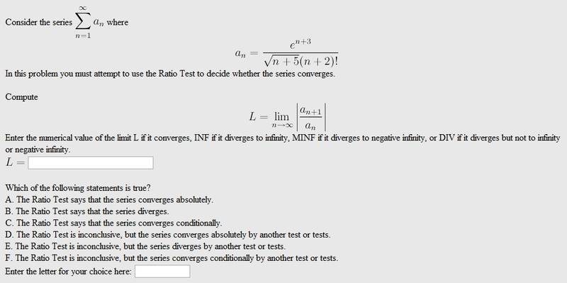

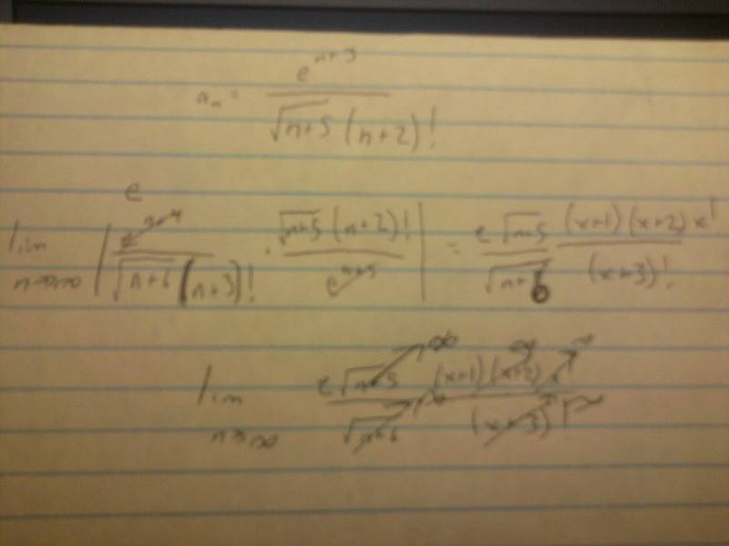

I got that the limit goes to infinity using the Ratio Test and that would mean B. But I'm not 100% percent sure. Just looking for some to verify my answer if I'm correct or not.

Your limit is wrong, because your ratio is wrong.
[itex]\displaystyle\frac{(n+2)!}{(n+3)!}=\frac{1}{n+3}[/itex]

Wow. I haven't used factorials in a while and forgot how they were used. Now looking at the problem I get L=0. That tells me that the series converges absolutely.
Thanks a lot. There are so many things is math to remember when solving a problem.
