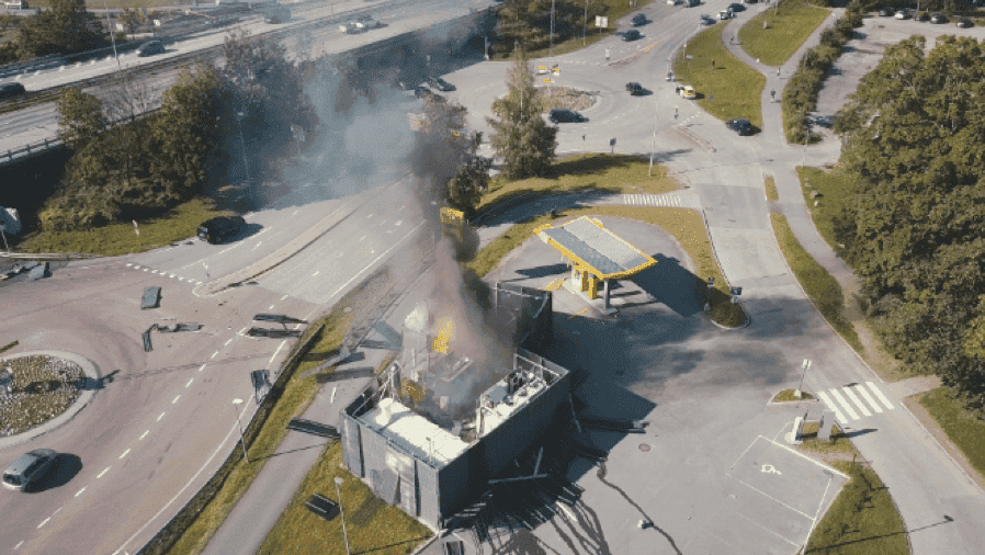

Stormer said:
Well close to where i live there was a explosion at a hydrogen filling station last year.
The investigation concluded that the cause was a leak because of two bolts on a hydrogen bottle that was not tightened enough. So yes small slow leaks of hydrogen can definitely cause explosions. At least in enclosed spaces. And in open places it can cause fires really easy.
Can you provide a link to a description of that incident? I'm seeing very little damage and evidence that the building was probably designed to survive a minor explosion (with blow-off panels).

Baluncore said:
You are imagining it. There is no problem with high altitude hydrogen balloons.
Am i imagining the exploded hydrogen filling station in the picture above?
Or am i imagining that a hydrogen balloon filling station will be essentially the same as a hydrogen car filling station except the customer filling parts? Look at the picture. The part that exploded is the elektrolyser and hydrogen storage building.

I have just showed you a hydrogen station that exploded just a year ago throwing debris everywhere. And this is one of only a few in operation in my country. If there was more of them the explosions wold have happened more often.
And burning off the hydrogen in the air before launch like NASA does with it's rockets will not work either. The rockets aluminium skin can handle the heat for a couple of seconds but i am pretty sure the ultra thin skin of a high altitude balloon can not.

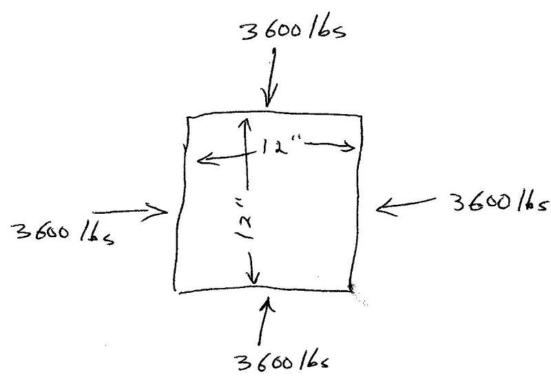

some bloke said:
Vacuum airships are a scifi idea where you evacuate the air out of a chamber to achieve lighter-than-air lift.
I'm wondering it would be feasible to use multiple layers of wall, with steadily increasing pressures inside, to prevent it from buckling under the strain.
Add another layer at 10psi and you have 3 walls, each only taking 5psi, but with a vacuum on the inside. I don't know whether this would be any lighter than just making the chamber strong enough to withstand 15psi, but that's beside the point.
My question is - would this work? can you stagger the pressures via sequential containers? or am I missing something?

Just for grins and giggles, I did some quick calculations for a vacuum airship. Some simple assumptions to get started include a tube 100 feet diameter with a perfect vacuum. The lift per foot of length at sea level is then the cross sectional area times the density of air: Liftperfoot=π/4∗1002∗0.075=589lbs/footlength.
The circumferential compressive force per foot length is Forceperfoot=14.7∗144∗100/2=106,000lbs/foot.
The longitudinal force per foot circumferential distance: Forceperfoot=π/4∗1002∗14.7∗144/(100∗π)=53,000lbs/foot.
Square feet of structure per foot length: 100∗π=314feet.
Maximum possible weight of structure is the lift per foot divided by the length of structure per foot: Maxweight=589lbs/foot/314feet=1.9lbsperfoot2. The sketch below shows this:
Not shown in the sketch is the vacuum force of 2117 lbs per square foot into the page. The absolute maximum weight of one square foot of the vacuum structure that withstands the above forces is 1.9 lbs. The structure must not buckle. The structure needs attachments for crew, cargo, engines, fuel, control surfaces, mooring, etc.
In practice, the airship structure must weigh about half that much, or about 1 lb per square foot, in order to carry crew, cargo, engines, fuel, control surfaces, mooring, etc. Any person who proposes a vacuum airship needs to do these calculations, and show a solution using commercially available materials
@jrmichler
Your computations are for sea level. Some things scale sensibly.
I think the idea of using an unmanned vacuum airship at 60,000 feet for mobile phone and internet connectivity is an interesting model. The air pressure at that altitude is only about 1 psi. The airship structure therefore need only counter a 1 psi differential envelope pressure. But the volume must be sufficient to lift the gross weight. At sea level the external pressure is about 14.7 psi, the same volume could have an internal pressure of 13.7 psi and generate the same lift force for the same structure. The differential envelope pressure would still be only 1 psi.
The OP's question, asking about multiple skins, can be dismissed since sea level atmospheric pressure differential will never be present. Any structure that survived with negative 14.7 psi envelope pressure at sea level would be too heavy to rise to an altitude where only one psi difference is available for lift.

jrmichler said:
A very quick ball park estimate convinced me that the mass of the pressurization air is significant, probably enough to make this concept impractical.
You are correct.
When considering the section through a vacuum chamber and wall, where the vacuum is opposed only by a pressurised, fixed thickness wall, the effects elegantly cancel to zero lift advantage.
So the structure of a vacuum airship must be kept apart by a solid material, not a gas.
I cannot see any advantage in a liquid filled double wall.
Following on from my previous post, regarding double walls or envelopes.
Altitude control of a lifting-gas filled balloon is not difficult, and there is no need to compress the selected gas. An external reservoir can contain compressed air. The pressure, and therefor the mass of compressed air can be used as adjustable ballast. That external tank technique could also be used with a vacuum balloon, but a simple vacuum pump would probably be a better investment since no lifting gas is involved, and a vacuum pump is essential to gaining altitude.
Where a balloon has two identical envelopes, one inside the other, the inner containing a fixed mass of lifting gas, can be very thin without any particular strength, since it has zero differential pressure. Buoyancy is changed by adjusting the air pressure in the outer envelope. That outer pressure changes the mass of compressed air, while also compressing the inner envelope lifting gas. That technique is not applicable to a vacuum balloon since it increases stress on the inner vacuum envelope.
