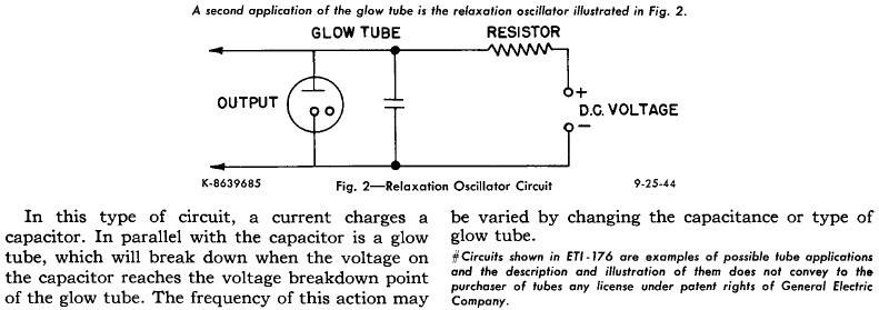

What factors determine the anode plate-to-grid capacitance? I know that the capacitance of a regular capacitor is determined by the surface area of the plates and is inversely proportional to the distance between them. Does this hold for vacuum tube grids and anode plates? The reason I'm asking is what are the ways to vary the anode-grid capacitance and in particular, how would this factor into designing a Thyratron that has sufficient capacitance to self-oscillate when there is a cathode-grid feedback loop. The idea of this device is to use it as a relaxation oscillator that can oscillate at audio frequencies(so sufficient large capacitance is required).
Here's something that may interest you from www.junkbox.com/electronics/sheets/GE_Glow_Tubes_ETI-176.pdf

Very Eenteresting! But it doesn't say whether or not the Metasonix thyratron sawtooth oscillator has external capacitors or is self-oscillating. Other types of tubes can oscillate without external capacitors, like the Tetrode for example.
Oh ? In my experience that indicated something bad wrong in the circuit.

Well old jim, I might have to actually do the hard work of designing my own kind of Vacuum tube. Tetrode self-oscillation, often called parasitic oscillation is considered undesirable in amplifiers but for an oscillator circuit that's another story. There is an assortment of electron tubes that will oscillate when a DC voltage is applied to them but those are mainly radio frequency and rely on electron bunching rather than capacitance, like the Barkhausen-Kurz tube, the cavity Magnetron, and the feedback Klystron.
In the case of the Thyratron I'm aiming for, both the anode plate and the grid would have a sufficiently large surface area and be positioned close enough together to act as an internal capacitor. There is a feedback lead from the cathode to the grid plate. A negative DC voltage is applied to the cathode and a positive DC voltage is applied to the anode. The inert gas acts a dielectric between the 2 plates. When the current is turned on, the positive anode potential draws electrons from the cathode lead into the grid. The capacitance must be high enough(along with a heating element to generate sufficient heat)so that when the grid plate is fully charged to capacity, it will reach ignition voltage. When the tube conducts, electron from both the cathode will move through the ionized gas to the anode in an avalanche cascade causing the cathode-grid voltage to drop and then the tube cuts off.
So why use a specially designed and built thyratron when you could use an external capacitance?
