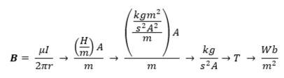

Need help if this equation that I thought of would indeed provide right values. I do not have a Tesla meter to compare my values with.
What I am trying to do is solving for the magnetic flux density of produced by a wire with AC voltage. So, I used ohms low (to use voltage as a variable) to calculate for the forwarding and reversing current
Where:
B is Magnetic Flux Density
Micro symbol is permeability
V_peak is the peak voltage of AC current
R is wire resistance (of the wire producing the magnetic field)
r is the distance from the wire producing the field
B(t)= μ[(V_peak (sin⁡ωt ))/R]/2πr
I tried validating the equation by somehow 'solving' only with the involved units.
Magnetic Flux Density – Tesla (T) – Weber (Wb) per square meter (Wb/m2)

B = ##\mu I/2\pi r ## I understand, but the 3rd term simplifies to HA so A must = ## \mu~ ##??
Sir, what do you mean by the third term simplifies to HA?
μ is the permeability and is with the unit, Henry per meter. It is also expressed in kilogram meter square per second square ampere square.
I tried doing the whole equation again and I seem to be getting AH/m^2 instead.
You're right, I made a silly mistake.
Like @kuruman I don't see why you question your "relevant equation". I also wonder why you wrote all those dimensional equivalents.
My knowledge of a B meter is limited to the Hall effect. The Hall probe measurs B as a linear function of voltage so there is no need to either differentiate or integrate the sine function.
Of course you are aware that Ampere's law, while universally correct, is limited in usefulness to very long wires.
Sir, I was questioning my relevant equation because it is involved in my research. I am having doubts as to if such an equation does represent reality, of course, it may not be accurate but, well, just close.
oh, they are called dimensional equivalents? I did those to check if the output value is indeed magnetic flux density. After all, the equation is composed of few laws.

The equation ##B=\dfrac{\mu_0~I}{2\pi r}## gives the magnetic field ##B## (conventional units Tesla) at distance ##r## from a wire carrying current ##I##. The wire is assumed to be "infinitely" long. Now anything physical like a wire cannot have a mathematically infinite length. For a finite wire of length ##2L##, the equation is valid when ##r~<<L##, i.e. the closer you are to the wire the better the approximation. The better the approximation the closer the equation is (in your words) to reality. Since you have not told us what this is all about, I cannot be more specific.

OK, if you accept that the right hand side of ##B=\dfrac{\mu_0~I}{2\pi r}## has the correct dimensions when the current ##I## is constant in time, then you must accept that when you replace this steady current with time-varying current ##I_{peak}\sin(\omega t)##, the right hand side will still have correct dimensions. That's because ##\sin(\omega t)## is has no dimensions like ##2## and ##\pi## in the expression. What carries the dimension of Amperes is ##I_{peak}.##
If you have doubts whether you should use the expression for your research, they should stem from whether the point(s) where you need to know the field is (are) far enough from the ends of the wire. In that case it might be more appropriate to use the expression for a finite segment of wire carrying current ##I_{peak}\sin(\omega t)## instead of ##I##. See here for several examples of how to do this.
