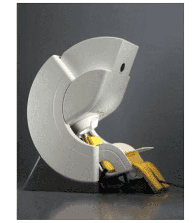

BTW, remember the movie "Brainstorm" where the Industrial Designer says "Nobody is going to put a thing like that on their head!" and then proceeds to redesign it to make it look way better? That's what I thought of when I saw this image at that link:
