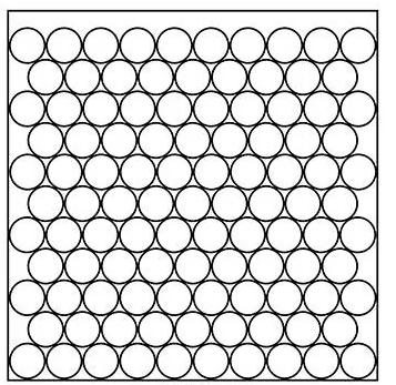

pgirl1729 said:
As weight only acts downwards and it's force is only exerted in downward direction. Then why does pressure acts in all directions?
The weight of the balls in the below image is also only exerted in downward direction, and yet they will push sideways against the walls. You don't need complex fluid dynamics to understand the basic principle qualitatively.
