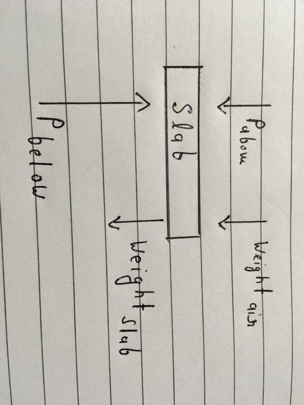

That [itex]Weight_{air}[/itex] is weight of the air which lies above the slab .
  • #38
##Weight_{air}## does not act on the slab. It does not belong on the free body diagram for the slab.
It acts on air above but slab is bearing that.
  • #41
So what? That is completely irrelevant for the free body diagram of the slab. Only forces acting on the body itself are included in a free body diagram. Were you not taught this?

  • #46
@Adesh let me explain how to analyze forces and draw a free body diagram.
Each force represents an interaction between two bodies. A contact force is a surface interaction between two bodies that are touching. Tension is a similar interaction between a rope or cable and another body. Pressure is a “collisional” interaction between a fluid and another body. Weight is a gravitational interaction between the Earth and a body, etc.
For each interaction we have in a scenario we can describe the type of interaction and the two bodies that are interacting.
In this case we have four bodies: the earth, the slab, the air above, and the air below. There is a gravitational interaction between the Earth and the air above. There is a gravitational interaction between the Earth and the slab. There is a gravitational interaction between the Earth and the air below. There is pressure between the air above and the slab. There is pressure between the slab and the air below. There is pressure between the air below and the earth.
This is a complete list of the important interactions in this scenario. Note that there is no pressure interaction between bodies that are not touching, and there is no gravitational interaction between the various air bodies.
Each interaction involves two forces, one acting on each of the two different bodies, and Newton’s third law says that these forces are equal and opposite. When you draw a free body diagram you include all of the forces that act on that body and none of the forces acting on other bodies.
Note, in the list of interactions I highlighted each occurrence of the slab. The slab occurred in three interactions, so there should be exactly three forces on its free body diagram. One is the pressure from the top, one is the pressure from the bottom, and the other is the weight of the slab.
The weight of the top air is not included because it does not act on the slab. It is an interaction between the top air and the earth, so it would be included in a free body diagram for the top air or for the earth. It is wrong to include it on a free body diagram of the slab.
I hope this systematic approach helps you understand how to analyze a scenario and correctly draw the free body diagrams. Once you have correctly drawn a free body diagram then you can apply Newton’s second law to analyze the dynamics of that body.

  • #47
Chestermiller said:
OK. So, if z is the elevation at the top of the slab, this means that $$p(z)=\int_z^{\infty}{\rho(\xi) g d\xi}$$where ##\xi## is a dummy variable of integration (representing elevations above z). This says that the weight per unit horizontal area of the fluid above z (right hand side) is equal to the pressure at z. Do you agree with this equation?
Wow. What a great explanation! I’ll always be grateful to you.
