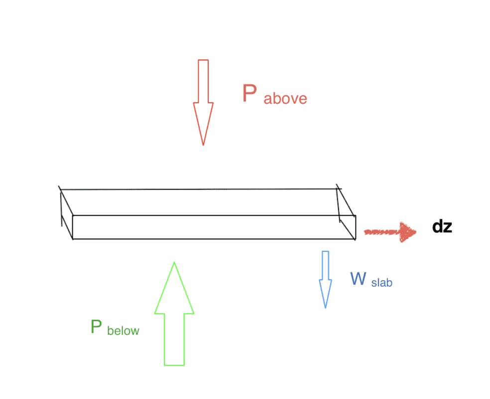

If we take a slab of air with cross-sectional area of [itex]A[/itex] and height [itex]dz[/itex] in our atmosphere. Now, what we do is make an argument like this :-
Pressure from below must balance both the weight and Pressure from above to keep the slab at rest. ( I have added an attachment for clarification)
And from this are argument we do something like this :
[itex]P_{above} = P[/itex]
[itex]W_{slab} = mg[/itex] , Pressure from weight is [itex]\rho \times A \times dz \times / A = \rho ~dz~g[/itex] ( [itex]\rho[/itex] is the density of air)
Therefore, [itex]P_{below} = P + \rho~dz~g[/itex]
[itex]dP = P_{above} - P_{below} = - \rho ~dz~g[/itex]
[itex]\frac{dP} {dz} = - \rho ~g[/itex]
Now, my question is why we didn't not take into account the weight of air which is above the slab? I mean the air which lies above our sample slab must have weight this weight would have been pushing our slab downwards and therefore pressure from below must also balance this. The mass of air which lies above the slab must have number molecules and gravity would attract them and we should center of mass and assume the gravity to act over there and this force of gravity should cause a pressure on our slab.
I tried to argue that pressure from above is due to weight of air only, but after sometime I thought that this argument is not good as fluid causes pressure due to collision of it's molecules .
So, I want to restate my problem again : Why in our derivation we didn't take into account the pressure caused by the weight of the air that lies above our slab?
Thank you, any help will be much appreciated. I tried to be as clear as I could be.
What do you think what ##P_{above}## is?
It is the collision of air molecules.
The weight of the air above does not act on the slab of air. Why would we include it in the forces on the slab?
When you do a free body diagram you include only forces acting on the body in question. In this case there are three such forces on the slab: the pressure from above the slab, the pressure from below the slab, and the weight of the slab. The weight of the air above does not act on the slab. Including it would be wrong.
That's what I want to know. Why including it will be wrong?
Because it doesn’t act on the slab. Only forces acting on the slab should be included.

OK, the air exerts a downward force. According to the 3rd law there must be a corresponding counterforce, acting upward on the Earth and according to the 2nd law the air would be accelerated if this would be the only force acting on it. But in the static case the air doesn't accelerate. Therefore there must be another force acting on the air. Do you agree? If yes, which force is it?
The weight of the air above is captured in the pressure above, ##p_{above}##

Adesh said:
therefore slab must be bearing the weight of the air above it (just like we bear the weight of something if we hold it over our head).
"bearing the weight" means exerting an upward force that compensates the weight. In this case it is the upward force I was talking about in #11. Does that tell you something about the origin of ##P_{above}##?

First, that force is the contact force, not the weight. Second, in many situations the contact force will not be equal to mg.
Adesh said:
therefore I would feel something heavy or being pushed down feeling.
Yes, that is the contact force, or in other words the pressure. Any influence that the weight of the upper object might have is transmitted to the lower object through the pressure. Once you have accounted for the contact force (pressure) then you have already accounted for the weight of the upper object.
