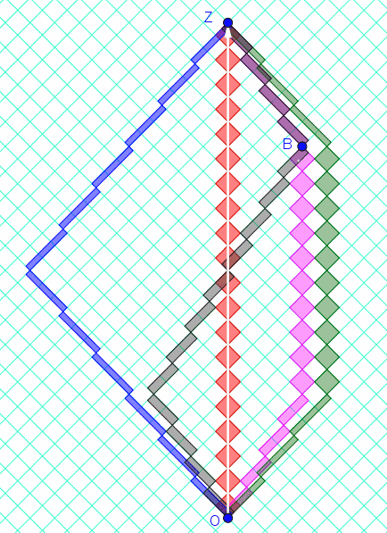

For the "twin paradox" the space-propertime diagram actually shows the age difference visually, unlike the usual space-coodinatetime diagram.

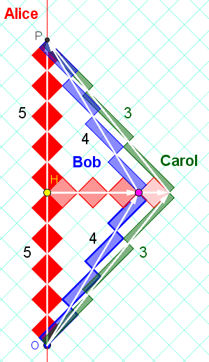

The usual Minkowski spacetime diagram,
when supplemented with the spacetime paths of light signals in a light-clock,
shows the differences visually... and quantitatively.

Yes, I am aware of this method and I like it too. But to see the age difference here is not as direct, as simply reading of the propertime coordinate in a space-propertime diagram. It requires a lot of additional content (the light clock signals)
I'm all for using multiple methods to visualize something.

When you animate current location of the bouncing light signal, the overlaid paths are less confusing. But I would not say that a space-propertime diagram is useful in this case. It's better suited for time-like worldlines.
