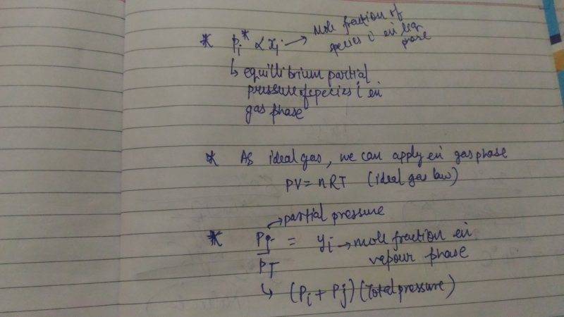

Roults law states that the equilibrium partial pressure of species i in the gas phase is directly proportional to the mole fraction of that species in the liquid phase . And the proportional constant is the vapour pressure of the pure component of that species i at the same temperature.
Sir what to do next after knowing the roults law?
If you have a liquid and vapor phase in equilibrium, and two components, please write out all the relationships you know of that describe such a system (for an ideal gas and an ideal liquid solution).
bX7CTK
Rahulx084 said:
bX7CTK
OK. Here's my take on this. Please let me know if you agree.
$$x_A+x_B=1$$
$$y_A+y_B=1$$
$$p_A=P^*_A(T)x_A$$
$$p_B=P^*_B(T)x_B$$
$$p_A=p_{total}y_A$$
$$p_B=p_{total}y_B$$
$$p_A+p_B=p_{total}(y_A+y_B)=p_{total}=P^*_A(T)x_A+P^*_B(T)x_B$$
$$p_{total}y_A=P^*_A(T)x_A$$
$$p_{total}y_B=P^*_B(T)x_B$$

What does small p ans capital P represents?
P• represents equilibrium vapor pressure of the pure component at temperature T and p represents partial pressure.

Got it now sir thank you .
One last thing , vapour pressure = saturation pressure right?
