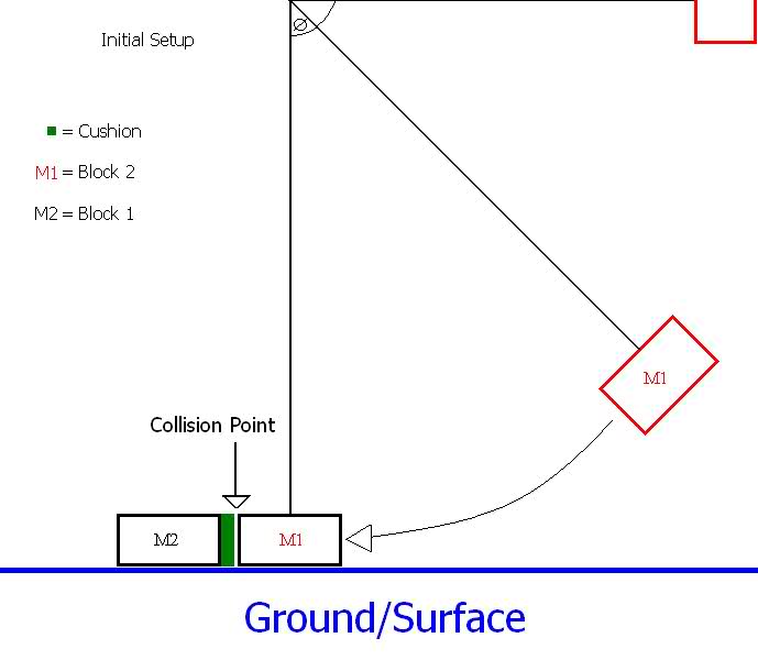

Okay, so I am a student in my first year of physics and I'm doing an EEI on collision; however I am stuck up to a part where I need to figure out the velocity of my pendulum without doing the experiments again (Long story). At the moment, the length of the chain/string is 55cm and the angle is at 90 degrees.
I have also done some googling, and some have ended leading me to here. Is this formula suitable to find the velocity?
v = √{2gL[1-cos(a)]}
I applied my known data into the equation which ended up giving me an answer of about 3.8m/s. I personally suspect that it is incorrect, so I need some experts to help me. (Sorry if i sound like a dag lol.)

It has a rectangular piece of wood (10cm x 4cm) @ 70g with a cushion, that weighs anywhere from 2g-10g. (It's simulating the crumple zone :P)
*EDIT: Sorry, so which formula would I use?
is the wood instead of a string (and if so, where is the pivot?), or is it on the end of a string?
in any case, you'll need to use the moment of inertia of a rectangle.
Before I go any further, do you know what moment of inertia is, and how to use it to calculate energy? :smile:
No idea :(
I don't really understand what you mean by where is the wood.
So here an illustration.
oh i see …
ok, if that long straight line is string, then your original equation should work,
with L being the length of the string plus half the height of the block.
(you originally mentioned a chain)
tiny-tim said:
oh i see …
Ah, yes thankyou. When I meant chain; I kinda meant the weightless support for the bob. Didn't know how to express it.
Thankyou again
