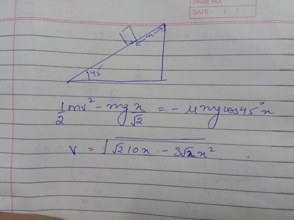

A body starts from rest on a long incline plane of slope 45 degree the coefficient of friction between the body and the plane varies as u=0.3x where x is the distance traveled down the plane the body will have maximum speed when x is
Work energy theorem
I used work energy theorem between initial top point and point x along the incline(downwards) i got the expression of v then diffrentiated it to get a maxima but it gives me a wrong ans which is 10/6 but the actual ans is 10/3 please tell me what i did wrong

There is a simple approach to this problem. Hint: what can you say about the forces when the body reaches its maximum speed?

There's almost no working there at all. You have an expression for ##v(x)## that you haven't justified. Did you integrate the friction force down the slope?
PS It looks like you just mixed up a factor of ##\sqrt 2## at some point.

Here's a neat trick. Maximising ##v## is the same as maximising ##v^2##. That makes the differentiation easier.
PeroK said:
There's almost no working there at all. You have a very simple expression for ##v(x)## that you haven't justified and is wrong in any case. Did you integrate the friction force down the slope?
Oh sorry i just forgot f was not constant and i integrated it now and got the correct ans thanks
