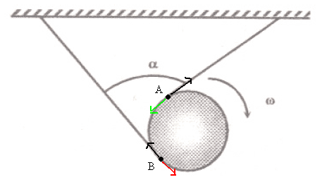

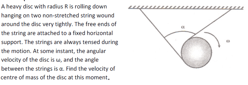

I think if I can locate the instantaneous axis of rotation ,then may be motion/velocity of CM could be determined . In the attached figure I have marked the two points A and B which are instantaneously at rest .The black arrows depict their respective velocities w.r.t CM .
Now consider point A . If it is instantaneously at rest ,then ##V_{CM}## has to be along the green vector .Similarly If we consider point B , then ##V_{CM}## should be along the red vector .
But that is a contradiction . I am not very sure if this is the right way to approach this problem .
I would be grateful if somebody could help me with the problem .

Locating the instantaneous axis of rotation sounds like a very good idea!
Are the points A and B instantaneously at rest? Hint: Are the strings changing their angles with respect to the vertical?
Yes . I have been thinking on this line . No , the points are not at rest . I am guessing that the left string is rotating clockwise whereas right is rotating anticlockwise w.r.t the support . Is that correct ?
So what should be the next line of thinking ?
Yes.
Can you see the direction that point A (on the disc) must be moving?
Before I answer your question , I would like to clarify ,whether it is correct to say that point A is instantaneously at rest w.r.t the string ?
Yes. It is like a ball rolling without slipping on a board that is being tilted.

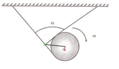

Are you getting ##V_{CM} = \frac{\omega R}{cos\frac{\alpha}{2}}##
In the attached figure ,the green dot represents the IAOR and red vector represents the direction of velocity of CM .
Does that make sense ?

I believe your answer is correct.
Did you have a look at the attached figure as well ?
Yes, it looks good to me. Something to think about: does the answer make sense for ##\alpha## approaching zero?
Thank you very much :smile:
Yes ,it makes sense. I am assuming this situation corresponds to when the two strings are aligned one on top of the other vertically (i.e both the strings are vertical) . In this case ##V_{CM} = \omega R##
Do you see any issue ?
A side question -
If a disk is rolling without slipping(accelerated/non-accelerated) on a stationary horizontal surface ,the bottommost point is at rest . Is it correct to say that this point does not have any kind of acceleration , neither linear nor centripetal acceleration ? I am concerned more about centripetal acceleration .
I think it makes sense, as you say. You can also think about ##\alpha## going to 180o, with the two strings horizontal.

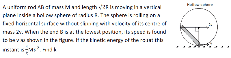

There is another problem involving similar concepts of rolling and use of Instantaneous axis . Please see the attached picture .
Do you agree that in the inertial frame moving with the center of the sphere
1) speed of the lower tip is 'v' towards left .
2) speed of the topmost point is 'v' vertically upwards .
3 rod is undergoing pure rotation about the center of the sphere .
4) the center of the sphere acts as the instantaneous axis .
5) the CM of the rod is moving with speed v/√2 .
I agree with all 5.
