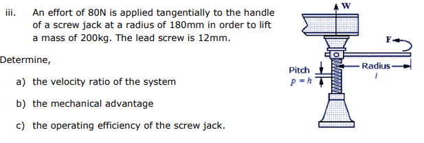

Hello,
I have completed the question below.
I am just unsure on whether i am correct or not.
I am unsure on Mechanical Advantage. As i have seen a few different equations.
Question:
Answer:
a)
Velocity Ratio = $$\frac{\text{Distance Moved By Effort}}{\text{Distance Moved By Load}}$$
$$VR = \frac{2\cdot\pi \cdot R}{P}$$
$$ R = 180mm$$
$$P = 12mm$$
$$VR = \frac{2 \cdot \pi \cdot180mm}{12mm}$$
$$VR = 94.2$$
b)
$$M.A = \frac{\text{Load Lifted}}{\text {Effort Applied}}$$
$$\text{200kg to Newtons} = 1961.33$$
$$M.A = \frac{ 1961.33}{80}$$
$$ = 24.51$$
c)
$$\text{Efficiency} = \frac {M.A}{V.R}$$
$$\frac{24.51}{94.2}$$
$$ = 0.26$$
Are these correct? If not where have i gone wrong?
Thank you.
Good to see that you keep going, Ben. :smile:
Rather than the pitch, the problem shows only "The lead screw is 12 mm".
I guess we can assume that 12 mm is the pitch or gained height for each turn of the nut.
Your results are correct.
Why are you unsure on Mechanical Advantage?
This problem is asking about the actual mechanical advantage, which is a ratio of forces or loads.
The ideal MA is a geometric ratio of distances, arcs or velocities.
Copied from
https://en.wikipedia.org/wiki/Mechanical_advantage
"The ideal mechanical advantage (IMA), or theoretical mechanical advantage, is the mechanical advantage of a device with the assumption that its components do not flex, there is no friction, and there is no wear. It is calculated using the physical dimensions of the device and defines the maximum performance the device can achieve."
"The actual mechanical advantage (AMA) is the mechanical advantage determined by physical measurement of the input and output forces. Actual mechanical advantage takes into account energy loss due to deflection, friction, and wear.
The AMA of a machine is calculated as the ratio of the measured force output to the measured force input."
Please, note that this jack is a compound machine or a combination of two simple machines: a lever and a screw.

For this screw jack, the input work (90 Newtons-meter or Joules) is the work done on the machine as the input force (80 Newtons) acts through the input distance (1.13 meters).
Nevertheless, the output work (23 Joules) is the work done by the machine as the output force (1962 Newtons) acts through the output distance (0.012 meters).
Hence, the efficiency of 26% that you have calculated (67 Joules of work will always be wasted, due to friction mainly, while lifting a mass of 200 Kg).
