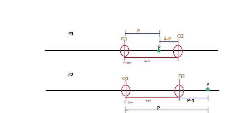

A +3.0 nC char age is at x= 0cm and a -1 nC charge is at x= 4cm. At what point or points on the axis is the electric potential zero?
V= [tex]\frac{kQ}{r}[/tex]
i have solved the question, first i tried two places, between the two charges, and after the second charge.
i solved for x= 3cm and x= 6cm.

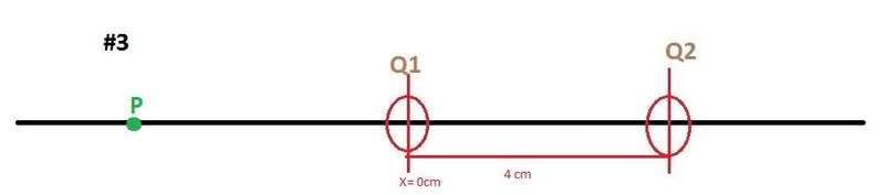

now the problem is what is i want to check in the negative zone?
now is in
the formula v1+v2 =0
for r1, do i use r1= -p and r2 = 4-p, i am confused about doing it in the negative zone, do i just use the magnitude, if only magnitude, it would be r1=p and r2=4+p, which do i use?

for r1, do i use r1= -p and r2 = -4-p, i am confused about doing it in the negative zone, do i just use the magnitude, if only magnitude, it would be r1=p and r2=4+p, which do i use?
Other than the underlined [ corrected ] part, both are actually the same. You just multiplied both sides by -1.
So you're fine either way.
i did it, r1=p and r2= 4+p, i get p=6cm, now when i go back and plug in p=6 in the equation it does not satisfy, but =-6cm works, but the answer from solving the equation is p=6cm not p=-6cm, i am confused, help please.0 = [tex]\frac{k(3nC)}{P}[/tex] + [tex]\frac{k(-1nC)}{4+P}[/tex]
I solved for p using the above equation and got p= -6
Maybe something wrong with your algebra?
even with r1= -p and r2= -4-p, I still get p= -6
