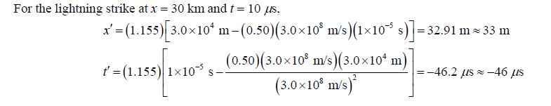

i calculated and got like
x'=3.291*104 ---->this does not match with answer key, but I am sure its correct.
could some one verify this pls
t'=-4.618*10-5---. this makes sense
It can't be correct, it doesn't have the right units.
What calculation did you do? Show your work...
i did the exact thing as the solution, i think they converted the x'=32917.5m to x'=32.9km and did not indicate it...
x' should be less than x. t' should be greater than t. Also a negative time interval doesn't make sense.
-ve means it happened before no?
They're the same thing (except for rounding), it's not necessary to indicate anything for that conversion.
And a negative time interval could make sense, if it's the time difference from A to B and B happened before A.
Anyway, I still don't see your work. Unless the image you show is actually the work you did? I thought it was the given solution.
Aha: I just checked the calculations in the image you showed. I can't say whether the calculation is set up correctly, but there is definitely an error. When I plug
[tex](1.155)\bigl[3.0\times 10^4\,\mathrm{m} - (0.5)(3.0\times 10^8\tfrac{\mathrm{m}}{\mathrm{s}})(1.0\times 10^{-5}\,\mathrm{s})\bigr][/tex]
into my calculator, I get [itex]32.9\,\mathrm{km}[/itex]. So the result shown in the image is off by a factor of 1000 - probably whoever did that calculation wrote the wrong units on the result.
its from a solution Manuel. I am 100% sure its wrong off by a factor of 1000
as i think is said it the solution give nis the same as my work that how i did it then when i looked at solution it was the same but off by 1 factor of 1000..so i was confused so i asked thanks for the help
