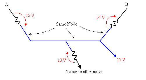

I am solving a VERY complicated exercise and I have this part that I don't understand.The image posted is a very big simplification of a part of the exercise.I have to find the potential between A and B.My question : Are the 15 Volt and the 13 Volt in the picture involved in the calculation?
I know I have to calculate the potential using Kirch.law btw.

Do the lines represent wires only? If so, the 13V and 15V sources have no effect on the KVL sum from A to B.
The lines represent wires and they have resistances in it.

Not if one end is open circuit. Are they really open circuit?
That's a confusing statement. Are the lines wires, with the resistances represented by the circled potential changes? Or are there hidden potential changes in the lines along the path from A to B?
Sorry.13 V is also resistance,15 V is only wire.

How can a wire be 15 V? Do you mean it is a wire that is at a 15 V potential, or leads to a 15 V source? Something like this:
Wire that has a 15 V potential.The image is very right!
Okay. Then consider that a single node can only be at a single potential; there is no potential difference between any points connected by a contiguous wire. In this case, the blue wires in the figure represent one node. The only potential changes that occur along the path from A to B are those due to the 12 V and 14 V drops.
