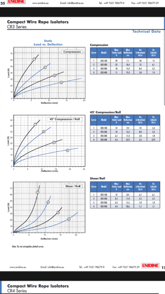

Hello i was looking at the damper CR3-100 as seen in the pic. Howver from the tech sheet given i cudnt make out what's the cutoff freq of this damper...i mean which is the frequency beyond which it doesn't let the frequency pass...what to make of this KN/m value?

I googled it. There is an application guide in the catalogue.
Its a mass spring system. The cut off frequency will depend on the modal frequency of interest (ie what mass is on the spring). Isolation usually starts 1.4x the natural frequency.
So it really depends on how much attenuation of vibraion you want. The catalogue suggests a natural frequency 1/3 the excitation frequency for 80% attenuation.

All you need to do is work through page 38 of the catalogue. What aspect are you struggling with?

From the catalogue it states that:
W < Static Max
Kv < Kv of isolator
So from the there are 4 tunes of isolator you posted in the OP. Which one works?
The reason why this works is that once you go past the natural frequency, the vibration is out of phase with the input. So you start to get attenuation. I suggest you read up on vibration transmissibility.
