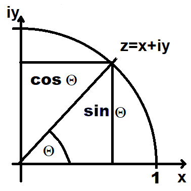

What is its geometric meaning, if I may ask?FactChecker said:Many people consider Euler's formula, ##e^{i\theta} = \cos(\theta)+i\sin(\theta)##, to be the most important equation in mathematics. I like its geometric meaning.
- 20,819
- 28,467
Agent Smith said:What is its geometric meaning, if I may ask?
We have the complex number ##z=x+iy = e^{i \theta}.## Its real ##x##-component is ##x=\sin \theta## and its imaginary ##iy##-component is ##y=\cos \theta## by the definition of sine and cosine at the right triangle. Together, this becomes
z=x+iy=\cos \theta +i \sin \theta
That the RHS equals ##e^{i \theta }## is Euler's formula.

That's really kind of you to explain what seems to be the relationship between complex numbers ##z = x + iy## and ##e^{i \theta}##. What does ##e^{i\theta}## do? Rotate ##1## by angle of ##\theta##?fresh_42 said:View attachment 348633

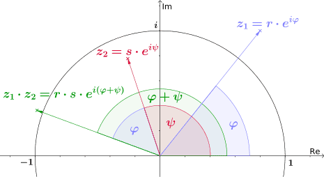

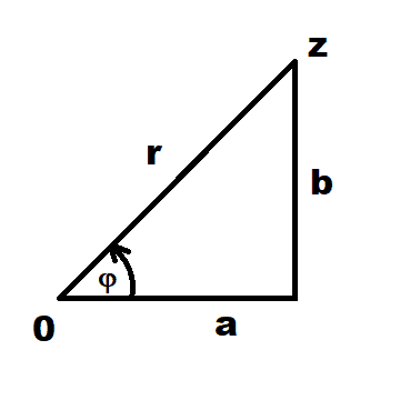

So ##e^{i \theta} \times z## will rotate ##z## counterclockwise by ##\theta##?
Once you studied/learned/accepted Euler's formula, and the Wikipedia link above has several proofs of the identity
e^{i\varphi }=\cos \varphi + i \sin \varphi
then it is quite easy. Every complex number ##z=x+iy## can be written as ##z=|z|\cdot e^{i\varphi }## where ##|z|=\sqrt{x^2+y^2}## is the absolute value of ##z## that is the distance from the origin ##0+i\cdot 0=0## of the coordinate system, and ##\varphi ## the so-called argument of ##z,## the counterclockwise measured angle from the positive real axis, the ##x##-axis.
Now we get
e^{i \theta} \cdot z = e^{i \theta} \cdot |z|\cdot e^{i\varphi }=|z|\cdot e^{i\theta + i\varphi }=|z|\cdot e^{i(\theta + \varphi)} .
The result is therefore a complex number of absolute value ##|z|## and an argument ##\theta + \varphi ## which is the original ##\varphi ## rotated counterclockwise (we always measure from the positive real axis counterclockwise, of course, if the angles are positive) to ##\theta + \varphi ## which is just a rotation by ##\theta.##
Source: https://de.wikipedia.org/wiki/Komplexe_Zahl#Multiplikation
The pictures in the English version were a bit messy.
