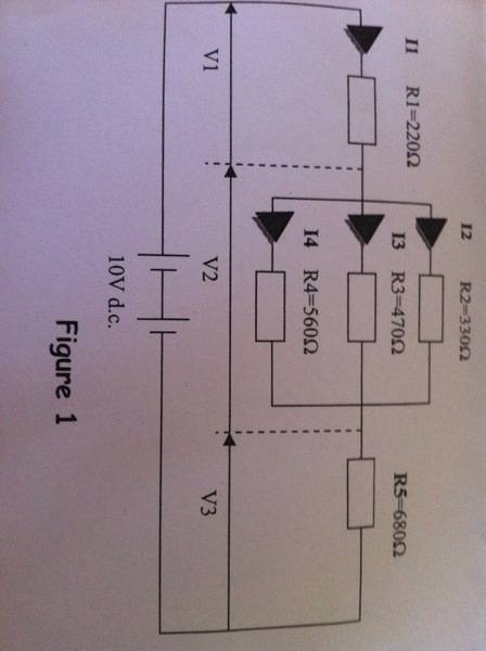

Hey, I have a circuit which you can see in the images attached.
I had 3 questions and I *THINK* I've answered one of them. But I can't seem to get to the next part. Here's the questions below
Questions:
a) The total Resistance (Rt) of the circuit.
b) The voltage across each resistor, V1, V2, V3
c) The currents I1, I2, I3, I4
Attempts:
a) What I have done so far is RT = 1/(1/330 + 1/470 + 1/650) = 144Ω
Series + Parallel = Rt = 220 + 680 = 900Ω (Series)​
900Ω + 144Ω = 1.044kΩ​
b) *Haven't really gotten that far* all that I've gathered is V= I * R I only have the variable R so I'm not sure what to do :(
You have the total resistance and the battery voltage so you can calculate the current from the battery. V1 and V3 should then be straightforward...

Alright I'll try that.. The current through R1 is 9.578mA and I suppose R5 should be the same ?
Can you now find V2? The resistors R2, R3 and R4 are in parallel
Well because they're in parallel wouldn't the voltage remain the same throughout each resistor? so If I fidn the voltage for one would they all be the same? My teacher is really bad sorry if these seems stupid !
You are correct, the voltage across R2, R3 and R4 is the same (do you know what it is)
So now you can calculate the current through R2, R3 and R4...

What's the equivalent resistance of the parallel resistors?
144Ω I believe...
You should be able to calculate V1 and V3...which should then give you V2 !

If that's the case, what's the voltage drop across that resistance?
I don't know how to work the v.d out :( I have it drawn on pcbwizard so I can check my answers but I need to be able to do manual way :/
Ohm's law! You've already calculated the current, right?
I have the current for R1 and R5, not the parallel circuit though ?
Surely it's the same current? R1 and R5 are in series with the equivalent resistance of R2||R3||R4. Note: The individual currents through the parallel resistors must sum to that.

R1, R5, AND the equivalent resistance for the parallel resistors all share the same current.

Let's call the equivalent resistance of the three parallel resistors R234. Then R1 and R234 and R5 are in series. They all MUST have the same current because they are in series.

By Ohm's law you know the voltage across R234. That voltage is therefore across all three resistors (parallel components all share the same voltage difference).
Alright I think I get what you're saying... So what I got is V2= I*R
V2= 9.578 x 1.044
V2= 9.999432V
And with that voltage I put it into Ohms law to find I2, I3 and I4 ?

That'll work! [EDIT: make sure that the resistance vale you use is the equivalent resistance of the parallel resistors! R234]
Also note that, as technician intimated previously, if you know all the other potential changes around a loop then you can find the "missing" one; the sum of all the changes must be zero. So knowing the battery voltage and V1 and V3, you can find V2 since Vbat - V1 - V2 - V3 = 0

9.99432 is your current value for the series current through R1, R234, and R5. It's NOT the current through the individual resistors R2, R3, and R4 (those individual currents will add up to 9.99432 though).
The reason that you found the voltage across R234 was so that you could use it to determine the individual currents through R2, R3, R4 using Ohm's Law for each of them.

Allowing for rounding errors they sum to 10V, which is the battery voltage. What's wrong with that?
No there's nothing wrong with that at all but I still don't understand how I find V1.
If the Battery Voltage is 10V and the Current Flowing in the circuit is 9.578mA and the circuit resistance 1.044KΩ, I don't understand what I have to do with these values to find V1, V2 & V3.
