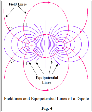

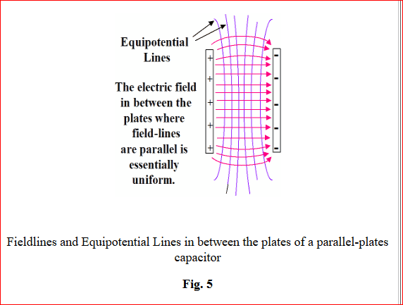

It might help your thinking to simplify your model
by changing from the complicated field that exists between two charges
http://www.pstcc.edu/nbs/WebPhysics/Chapters%2025%20and%2026.htm
to a simpler uniform electric field such as exists between two large parallel plates.
same link, http://www.pstcc.edu/nbs/WebPhysics/Chapters%2025%20and%2026.htm
Think "Millikan Oil Drop Experiment " for a minute ...
It should be intuitive that in the bottom diagram,
if the field is E volts per meter
a single electron will acquire or give up E electron volts for each meter in moves along a field line.
Electron volts to Joules is straightforward enough. Hmm, it looks mighty close to ~1/6.2E18 , a familiar enough number...
Approach: Make your math work for a simple model, then hone it for the more general case.
Any help ?

Ok, I think I understood a lot.
So, I understood that I can't really derive voltage in the electric field between two point particles or one charge and one point particle, as the maths background and understanding needed is beyond my capabilities, furthermore the electric field isn't constant, hence the integral. I got the formula for potential and voltage though, but only for point particles and an electric charge distribution of a “sheet” (?).
I can derive the voltage in a constant electric field like the one between the capacitors (that is fairly easy and stems from the definition of the electric field between two parallel plate capacitors)...easy electric field there.

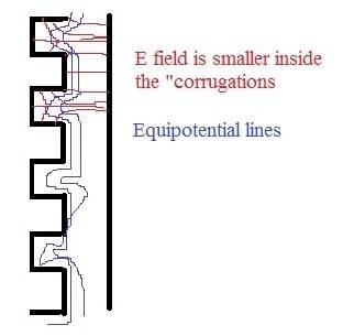

Here's an example that relates to OP's plight... (Oh No , another Boring Anecdote !)
There exists around reactors a need for a gamma ray radiation detector that has electrically adjustable sensitivity.
Those WW2 geniuses figured out how to do it.
They create an electric field between two plates, but one of the plates has exaggerated "corrugations". Those two plates form the walls of a gamma ray detector that's filled with ionizable gas.
Voltage is impressed between the plates.Gamma rays ionize the gas and charges migrate to the respective plates.

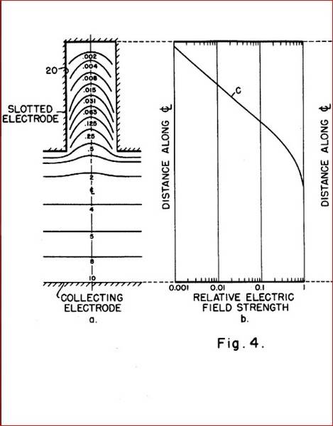

Somebody had to calculate the field inside those corrugations but i had to settle for drawing the field as if it were a hydraulic flow problem.
In the narrow parts of the chamber E field is simple, constant Volts/meter just like between two parallel plates.
Within the deep corrugations however it's not so simple
please pardon my artistic awkwardness
here's a better drawing from the patent but it's rotated 90 degrees
http://pdfpiw.uspto.gov/.piw?PageNum=0&docid=02852694&IDKey=AF8EA366EA31 &HomeUrl=http://patft.uspto.gov/netacgi/nph-Parser?Sect1=PTO1%26Sect2=HITOFF%26d=PALL%26p=1%26u=%252Fnetahtml%252FPTO%252Fsrchnum.htm%26r=1%26f=G%26l=50%26s1=2852694.PN.%26OS=PN/2852694%26RS=PN/2852694
Equipotential lines, always perpendicular to Efield lines (just as in fluid flow problems) distort over(up in good drawing ) into the corrugations.
As field inside the corrugation weakens it becomes too feeble to collect ions and they recombine instead of moving toward a plate.
By adjusting the applied voltage one controls how far into the corrugation that happens, which effectively adjusts the volume(hence sensitivity) of the detector.
That's the heart of our reactor wide range power meter. It works over eight decades of power , from just above startup to 100%.
