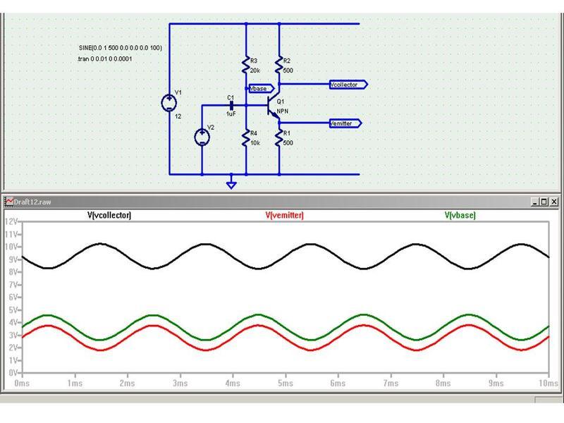

In the following diagram, look at the ratio of voltages between the base and ground and base and the supply voltage.
Assuming the base current is negligible compared with the current in the resistors, then the resistors must also be in this ratio.
General rules like "this one must be 10 times that one" might still produce a working amplifier, but the proper functioning of the network will be lost.
If the supply was only 4 volts, then the "this one must be 10 times that one" rule would produce only produce 0.36 volts on the base and the transistor would not even turn on. So, it wouldn't work at all.
