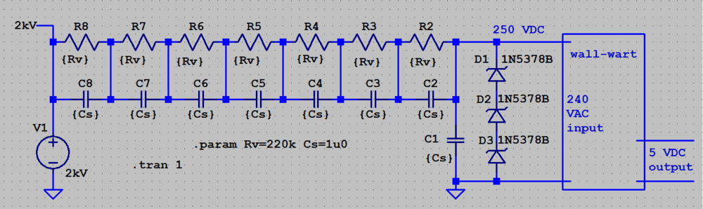

I would like to know if I can connect buck converters in series. I am looking at the LT1170HV specifically
I have two capacitors in series across my bus. I have a some series resistors across the capacitors for voltage balancing. I would like to power some low voltage low voltage components tapping off of the voltage divider using that as the voltage supply.
The bus voltage will be approximately 2 kV. The DC/DC converter I'm planning to use is the LT1170HV which has a maximum input voltage of 60 V. I would like to operate this near 20 V and need a load current of approximately 20 mA at 5 V. The application note for this chip recommended a minimum load of 100 mA so I guess I'll have to add a dummy load on the low voltage side to draw more current.
To find the input current to the converter, I used D=Vo/Vin and Iin=D*Io. With Vin=20 and Vo=5, I get D=0.25 and Iin= 25 mA.
Since this converter will be in parallel with a resistor from the voltage divider, I'll assume the input input impedance of the converter is equal to the resistance of the parallel resistor used as its source. In that case, the current through the voltage divider must be 2*Iin or 50 mA.
To get current of 50 mA through the voltage divider, Req=2000/(.05)=40 kOhm
Using Zin = Vin/Iin, and Iin= 25 mA, I find Zin=800 Ohm.
The voltage divider would then look like some number of resistors totaling approximately 39.2 kOhm with a 1.6 kOhm resistor at the bottom. With the converter connected and drawing power, the equivalent resistance of the would then be approximately 40 kOhm (in the ideal world) i think right?
I'm sure there are a lot of problems with this approach so please berate this approach and help me find a better solution. The first problem that I see is the resistors would be dissipating roughly 100 W. Actually, that piece alone stops me from going further with this. Is my math and approach correct from all of the steps above?
I was thinking maybe I could use several converters in series so I could tap off a higher voltage requiring a lower input current. I would have to series several bucks to get down to 5 V because the converters that do like 700/5 V conversion are WAY outside of my price range.
Any recommendations are greatly appreciated.

I would ditch the LT1170HV and do a more discrete design. If you use a 1KV MOSFET you can easily operate at 400V instead of 20V at the input which will drop the power in the series resistor by a factor of 20x or so. You will not get the requisite ~1% duty cycle from most control ICs, but this isn't such a difficult thing to solve. Since the load current/power is small you could design a crude SMPS, perhaps with a hysteretic (bang-bang), or fixed on-time controller, and then follow it with a linear regulator.
This is the sort of design that will benefit from some system engineering up front, before you start choosing parts. I think there are a few different approaches possible, but none will be "off the shelf" applications.
Pay extra attention to protection due to transients, boundary cases, abnormal operation, start-up/shut-down, etc. Operating a 60V, or 1KV circuit from a 2KV source is an easy way to accidentally destroy things.
You have 2 kV, in two series capacitors. That is 1 kV each.
Change that to 8 capacitors in series, to get 250 volts across each.
Quarter voltage, four times the capacitance = same physical volume.
Get a miniature 250V AC input switching converter off-the-shelf, to produce 5 V @ 20 mA = 100 mW. Internally the AC will be rectified to charge a capacitor to 350 V. Feed it instead with 250 VDC from across the lowest capacitor, closest to the 5 V supply ground.
Protect the switcher and lower capacitor with a 300 V chain of zener diodes.
Use voltage balancing resistors across the remaining caps in the chain.
Assume 250 mW maximum switcher input. 0.25 W / 250 V = 1 mA.
250 V / 1 mA = 250 k maximum balancing resistance per capacitor.
The voltage balancing chain now dissipates 2 watt total.
Normal resistors are only rated 100 V. Balancing resistors must be rated to 250 V or built up from series chains.
This may be "simple" but sounds pretty complicated for me at the moment. I'll research this so I have my options for future designs. Thanks for the suggestions.
This will work, but derate the AC-DC PS some. There are occasionally some differences in running the input circuits on DC. For example input rectifiers don't heat evenly.
It's probably irrelevant in this case, but this will often violate the safety approvals for an AC-DC PS. Because of component stresses, or, really, they just didn't write it up in the paperwork or do the testing for DC. Also connecting to a 2KV source will violate the safety approvals unless you demonstrate fail safe circuitry, probably with double or reinforced insulation, to reduce the voltage.
