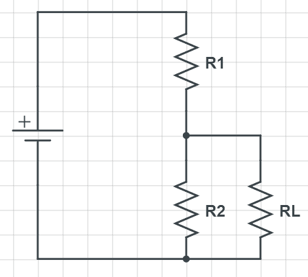

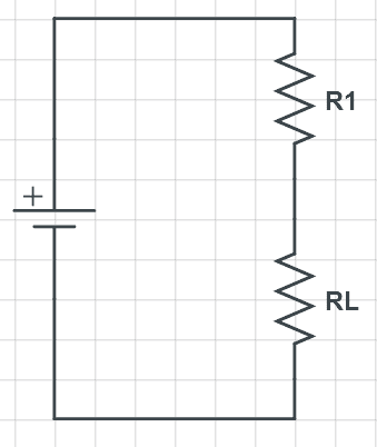

I have two questions.
1. A lot of voltage dividers are wired up like this:
Is there any reason why they can't be wired up like below?
2. When should a voltage regulator be used instead of a voltage divider?
Voltage regulators should be used whenever economically viable because all power going through R2 in fig 1. is completely wasted. But if you are just using the voltage as a signal, say for digital logic, and there isn't any significant current flow, then voltage dividers are perfectly fine.

RL=Resistance of the load.
many times it is a variable value.
If your divider was setup in the topology you suggested in your second picture, the voltage across RL would change a lot as RL changed. If it was setup as suggested in the first picture, It would not change as much.
Also when you get to transistors, you will see why it can be advantageous to use the first topology.
Both of the diagrams in the OP will work but the voltage across the load is very dependent upon the value of RL. That could be very embarrassing for the function of the circuit being supplied (RL). A voltage regulator will produce the correct voltage at the output by altering the current it supplies, (using a transistor - or equivalent) effectively as a variable R1, to keep the ratio of resistances right for the required output volts. That's a dynamically adjusted voltage divider - if you like.

circuit 1 is a voltage divider, circuit 2 isn't
voltage divider circuits DONT provide any regulation and as sophiecentaur said ...
