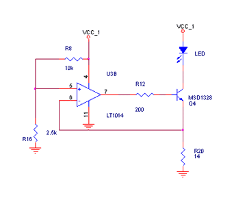

Here is the basic idea -- you sense the voltage across the bottom resistor to servo the current to the value that you want. This circuit servos it to a fixed value, but you can use a microcontroller (uC) or even just a potentiometer to servo to a range of currents:

Okay, then you want to use low-side sensing of the current as I showed and use your control circuit to set the levels. Will you be prototyping the circuit for this? We can help you design and build it...

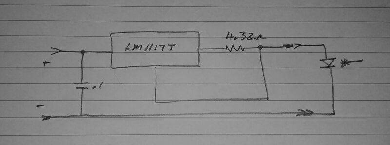

At first we wanted to power the diode and be able to vary the current to vary the output power of the laser, but at this point we want to just be able to take the original input DC supply (Lithium-ion batteries 3.7V Nominal) and be able to power the diode at a constant current of 290.122 which in the I-V curve equals 1.557V (This will produce about 94mW output power). Which would be the best approach to do this?
You can try something like this:
