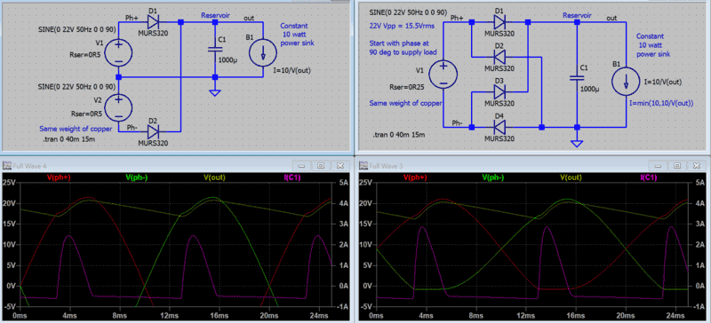

Simulation of full wave diode rectifiers driving switching DC-DC converters.
Notes;
Design here is for a supply to a switching regulator with 10 volt output, 1 amp load. That is 10 watt. The reservoir cap has been reduced to 1000uF to show increase ripple and variation in regulator input current.
The regulator input is modeled as a voltage controlled current, I = 10 watt / Vout. That model will not start because an initial infinite current is needed. A simulation work-around is to either set a limit such as I = Min( 10amp, 10watt / Vout ), or to start the supply at 90° phase so the secondary AC peak voltage is present initially.
Secondary no load voltage is set to Vpeak = 22V. The winding resistance reduces that to 12V RMS under full load. The same weight of copper is used in the transformer secondaries. Consider the same two secondary windings, connected in parallel or series. The resistance of the windings is set to 0.5 ohm each for the two diode simulation. In parallel that makes 0.25 ohm for the bridge simulation.
Conclusions:
The diode pair has lower peak diode current than the bridge because it takes more voltage and so more time to turn on the two series diodes in the bridge. As expected, the output voltage of the pair is also higher than the bridge by one series diode drop. Increasing the reservoir capacitance increases the peak diode current, reduces the conduction angle and makes for a worse PF.
The diode pair beats the bridge in energy efficiency. The only advantage of using a diode bridge appears to be that you have less secondary terminals on the transformer which weighs the same.
If the load (arduino) has an on board linear regulator, set the switching regulator output to the minimum acceptable voltage for the load. That will reduce heating of the linear load regulator and reduce the supply current from the reservoir to the switching regulator.
See attached graphics image. LTspice files available on request.
  • Two LTspice schematics of full-wave rectifiers feeding a 1000uF reservoir and a 10 watt sink, with waveform plots below showing V(ph+), V(ph-), V(out) and I(C1) over 0 to 40ms.
