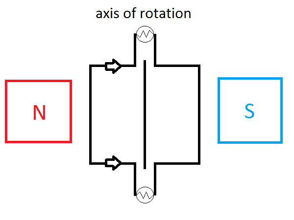

Hello, I don't understand how more loops in the AC generator create bigger voltage. I understand when we talk about magnetic flux how it happens (rate of change of surface that's penetrated by field lines), but there's also the explanation that says "if the magnetic field penetrates the paper, and if the conductor moves to the right, then the force will be upwards", now by force, since it's actually creating a voltage source, (the force acts on positive charges, and the current flows from + to -) is equivalent to conventional current direction.
So the picture is here: http://sciencecity.oupchina.com.hk/npaw/student/glossary/img/slip_rings.jpg
Now if you look at the loops you notice that if the loop that's farthest from the center of rotation actually moves like a tangent to a small circle, so it doesn't rotate, it goes in circles! Now if the loop were in the position that the holes were on the sides and the wires were up and down, then, looking from the north pole side, the lower part of the loop moves upwards, but SO DOES the upper part of the loop (because they aren't in the center of the rotation).
Since both upper and lower parts of the loop move upwards, by the left hand rule I described earlier the current goes in the same direction in upper and lower part of the wire; since the wire of the loop is continuous, the currents (voltages) should interact and annihilate one another. Why isn't this so?

I see three loops in that diagram ... the center of each loop is on the axis of rotation. So all the loops are equally far from it.
Do you mean the biggest loop? That's just the way the diagram is drawn.
...actually moves like a tangent to a small circle...
... the loop rotates about an axis through it's center, it does not move on a tangent.
Do you mean that the part of the wire drawn close to the magnetic pole moves on a circular path?
... rotating is a form of going in circles. The upper diagram shows loops rotating about a common axis.
The whole loop rotates. Every part of it.
... you have misapplied the right hand rule.
The current should go in the same direction in every part of the wire.

Maybe I wasn't clear on what my question was. It's, how is it possible, if you apply the left hand rule (we use the left hand rule that's the same as the rule you provided on that link) that the voltage is multiplied by the number of loops?
The lower diagram is the same as the upper picture but it's more clearer because the loops are smaller so you can clearly see that the loop that's the farthest from the center of the coil won't rotate around itself, but around the center of the rotation, which is in the middle of the coil. When you have only ONE loop, the rule is as it's shown on the link you've written here, and I'm using that same rule for when there are more loops, more turns. I draw arrows on the diagram that are velocity vectors, and it's clear that both parts of the loop (loop is an unconnected ring that has upper and lower half) upper and lower have the same velocity vector. So if you apply the left hand rule to this ring, they will have the induced voltage in the same direction. Since both parts of the loop are obviously connected, the current will have two directions, so there won't be any current. Which is different from the case when there's only ONE loop, when you again have 2 halves but since they go in different directions (have opposite velocity vectors), the voltage is induced in the opposite ways which means, because the wire is connected, the current will flow in that ONE loop. BUT here we have more loops!
When I said the farthest most loop doesn't rotate, I meant it doesn't rotate around itself, but around the axis that's in the middle of the coil; which is the main reason I cannot understand why there actually (experimentally) is current.
Think of it this way and only consider the sections of wire that are parallel to the axis of rotation: Every piece of wire that is moving upwards, is producing a small emf and all those emfs are in the same direction. All the pieces that are moving down are producing emfs in the other direction. So all those emfs are acting in the same sense around all those separate looks of wire and will add together around the (many) loops - giving a resulting total that is 2n times that of just one of the lengths of wire. This is like when you include more and more series batteries (connected the right way round) to get more volts. This total will alternate as the respective sides of the coil rotate through the field, going up and down through the field. The sinusoidal nature of the variation is because the speed that the coils cut through the field lines changes as the coils rotate (maximum when the motion is at right angles to the lines).

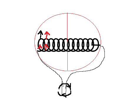

I think you are confusing the two types of coils and superimposing them into one unit.
The upper picture shows 3 loops of straight wire (cyan with arrows depicting the flow of voltage) and the lower picture depicts a coil as in a solenoid where the charge/force would be left/right on the surface of the paper.
If you superimpose the coil onto the straight wire (cyan) then you are correct, no voltage would be created rotating the large coil of smaller coils.

I was trying to figure out something myself when the misconception of the OP struck me so I stated the simple error neglecting the implications.
sophiecentaur said:
Even for the loops that are traveling 'around' the axis, there will be a greater emf produced in the outer parts than for the inner parts (which would be in the opposite direction) and produce a no-zero net emf.

I never said something like that. I want to just give more loops to the first picture and make it clearer. The arrows represent the velocity vectors of the conducing wires that SHOULD BE parallel to the axis of rotation (but in case of coil, they aren't). Applying left hand rule to this case, and the voltage created should annihilate because the vectors can be of the same direction on the same loop.

Talking about a armature that consists of several loops but we are looking at the loop that's farthest away from the center.
If both wires are parallel and are parallel to the poles and are for example near the north pole. If the whole loop is moving upwards, at that moment both upper and lower wire are moving upwards meaning voltage is induced, but yes, since upper wire's velocity vector is almost near the top (near 0 angle with , meaning no voltage, the lower wire will provide voltage that will overcome the small one from upper wire. So net voltage will exist.
We're talking about motion around an axle. If they are at different radii or at different angles (anything but absolutely co-incident) then they are not going at the same velocity. Hence, there will be a difference in the induced emfs. (Except, of course when the motion of both is parallel to the field lines; that's a zero crossing of the AC)
