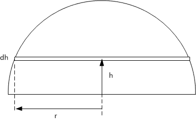

and what is the relationship between ##h## and ##r## ?
maybe ##h^2 + r^2 = R^2## where ##R## is a constant specifying the unchanging radius of the circle?
##2h{\frac {dh}{dr}} + 2r = 0##
##h{\frac {dh}{dr}} + r = 0##
##{\frac {dh}{dr}}= -\frac r h##
##h {dh} = -r {dr}##
##\frac {h^2} 2 = -\frac {r^2} 2 + C##
When h equals 0 at the same time r=R so
##0 = -\frac {R^2} 2 + C##
##C = \frac {R^2} 2##
And that means the solution is
##\frac {h^2} 2 = -\frac {r^2} 2 + \frac {R^2} 2 ##
Which is back where you started from.
I see what you are saying I think, the equation at the bottom is the same as the one at the top.
it is not obvious, but if you study the figure in post #4, you may obtain archimedes' result, that the volume of the hemisphere, equals the difference between the volume of the circumscribing cylinder and the volume of the cone. (hint: it uses Pythagoras to prove the analogous fact about the slice areas.)

note that h is also the radius of the circle cut by a horizontal plane from the inverted cone of height and radius R. Hence the formula h^2 + r^2 = R^2, shows the horizontal slice areas of the cone and hemisphere add up to that of the cylinder of height and radius R. Hence the same holds for their volumes. I.e. volume of hemisphere = πR^3 - (1/3)πR^3. This is archimedes' solution, without integrating.
