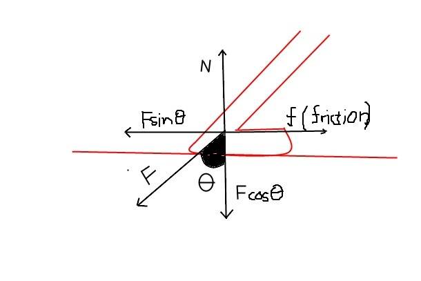

Why is friction necessary for walking? For moving/walking ahead we just need that when we push the ground the ground pushes us back. Can't we push the ground if the ground is frictionless?

Make an FBD of a person walking
Ok. Got it.
But when I draw the FBD, the force which with which the feet pushes on the ground is inclined at an angle of θ with the vertical. Let the force which we exert be F. There Fcosθ=N(Normal Reaction by the ground) and Fsinθ=f(frictional force)
So the horizontal forces balance then how can we move forward?

Can you show the FBD you draw to us?
The normal force is not an action reaction pair with gravity! This seems to be a really common misconception; the reaction force of the Earth's gravitational pull on you is simply your pull back on the Earth. Action reaction forces act on two different interacting objects, not on the same object.
Here.
And WannabeNewton, yes that is correct. We generally assume that because of the FBDs we draw. In fact I don't find any difference between what you said? Not a reaction force to gravity but a reaction force for the force by which the Earth is pulling us, i.e the gravitaional force? Aren't gravity and gravitation one and the same thing?

This FBD is not correct. FBD only shows Force acting on the object. Not the forces exerted by the object. Only the forces acting on the object(that is external force) effects the motion of the object. Re-draw the FBD showing only the forces on the object. Remember Newtons second Law, it says about external forces only.

Your FBD only shows the foot. As it stands.. The amputated foot isn't moving (it's not sliding along the ground) so the forces must sum to zero.
You can counter by pointing out that the body is moving but your diagram does not show the body or the other forces acting on it.
If you show all the forces on the whole body it should become clear. For example the reaction force N is behind the centre of gravity.
