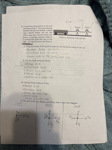

I have the solution I just want to know the intuition behind it,
So you have a frictionless box being pulled by two people. The first person has a rope connecting them and the box, the second has a rope that goes from the first to the second and lastly a rope that goes to the machine that pulls the rope. Draw the resulting free body diagrams for each one.
F=ma
For the box I understand it’s just normal and force of gravity as well as tension pulling them, it was declared to have no friction so it just points up down and right. It’ll be accelerating right.
The second person again has the normal force, gravity and the tension going to the left as a result of pulling the box. This is where I get confused, why is the friction in the direction of the tension of the third person pulling the first person? Is it because they are pushing off the ground?
Lastly the same thing would apply to the last person.
I’m having a hard time trying to understand why, we haven’t gotten far in my fundamental physics on friction mostly just basic principles, so that may be why but any help on why this is the case is greatly appreciated!

Personally, given the problem, I'd tend towards arguing that ##F_g## does not act upon the bodies for the purpose of diagramming, but enables the bodies to act against the ground, countering that normal force. You may or may not get yelled at for that, though.
The problem states "There is no friction". What elements of the system have you chosen to have, or have not, friction ?

I assume the "no friction" bit at the end is crossed out, not highlighted.
Since the cart is accelerating to the right and the black rope remains taut, the first person must be accelerating to the right at least as fast. But we are not told what action that person is taking with her body. If merely standing (but pulling with her arms), she is being dragged to the right and friction is to the left; but if she is actively hauling to the right friction on her feet is to the right.
Btw, it is better not to describe a force as merely "the normal force". A normal force arises between any two bodies in contact. You should always state which other body exerts a normal force, in this case, the ground. I have seen students form the belief that a normal force is always vertical.

Is the official solution of the problem stating the direction of friction?
Sorry, I don’t see a representation of friction in any of your free body diagrams.
When walking on a hard surface, it's the friction force exerted on you by the surface that propels you. If you doubt this, try walking on a wet ice rink.
Well, there are some things that need clarification before we can figure out what is really going on.
  • Is the "no friction" at the end of the problem statement crossed out, or highlighted? Without knowing that, we don't know if there is friction exerted on Denise and Cindy.
  • If there is friction, do Denise and Cindy remain in the same place, or do they move/accelerate? Do they move/accelerate in the same direction as the cart?
  • Why is "friction" listed among the forces exerted on Cindy, but missing in her free-body diagram?
