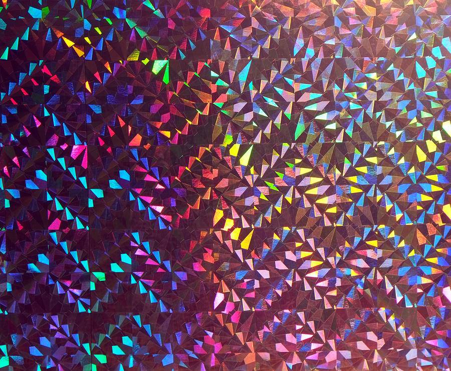

Thank you all for your advice so far.
I was thinking, since it's fairly complex to deposit glitter onto a paper, what if I just printed on top of reflective paper with enough spacing between the pixels to give the appearance of glitter? Although the ink wouldn't be reflective, every other pixel would be.
I'm hoping to achieve something like the sheet in this image.
Obviously that image is printed with normal colours. Do you want the small patches to glint and change brightness as you change the direction of illumination or your viewpoint?
Yes that’s exactly what I need
A variety of patterned iridescent papers are available from craft and art stores.
Print on them, cut to size?
They are usually light weight paper, but could be glued (or adhered in some way) to something thicker and then cut.
Laminating with foils is a popular hobby (I'm told) so perhaps see what one of their forums recommend?
I think some patterned foils are made by laser engraving or pressing fine lines into plastic film before it's metalised? Think that might be difficult to DIY.
