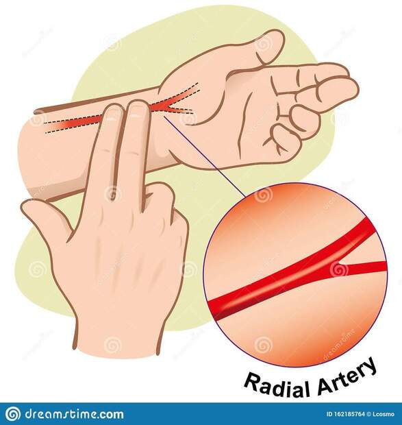

So my suggestion for a better way to try to do such a recording of the pulse mechanically would be to come up with a probe tip that you can locate over the radial artery in the wrist, and record the small bounces/movement as the pulse makes the radial artery expand with each heartbeat. You can feel your own pulse as shown in the diagram below -- the radial artery is located on the under (anterior*) side of the wrist, between the radius bone and the tendons in the middle of the wrist. Use 2-3 fingertips to press gently into that notch, and find where you can feel your pulse. Then try that on a few of your family members and close friends, to get an idea for the variations in where to find that radial pulse.
You could design some sort of little see-saw probe that is spring loaded and tilts up and down with each heartbeat a little bit (maybe 0.1" or so?). Then you can come up with some sort of graphical recording mechanism like you described in your post.
Let us know what you find! :smile:
https://thumbs.dreamstime.com/z/fir...mative-medical-guides-first-aid-162185764.jpg
* The "anterior" side of the wrist is for the "standard anatomical position", which has the arms and hands rotated so that the palms of the hands are facing forward, toward the anterior side of the person.

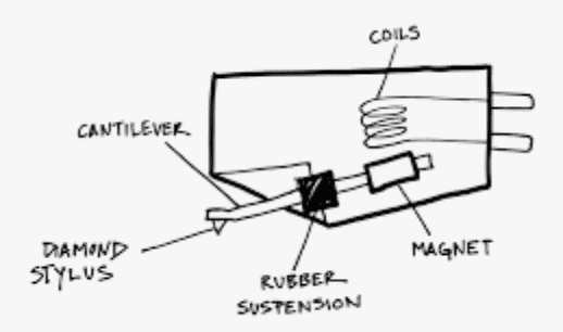

Would a record player needle/cartridge work?
Could be hooked up to electronics.

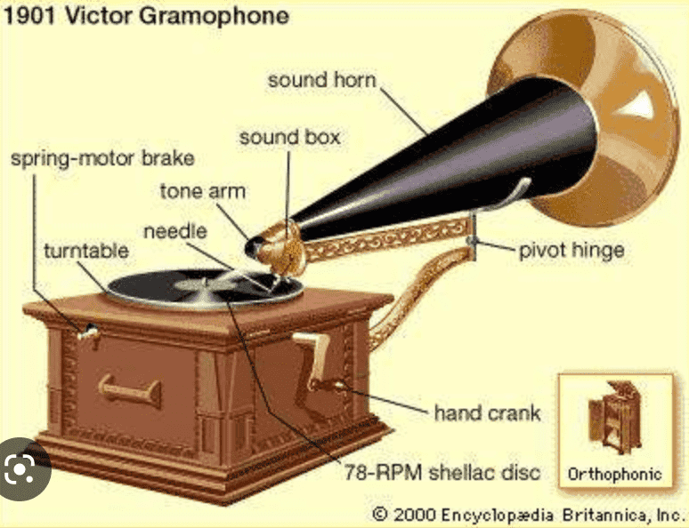

DrBanana said:
BillTre's idea seems promising but I don't know where to find a record player (plus it's gonna use electronics anyway).
There used to be mechanical phonographs:
Basically 'no-chance', I'm afraid. Th reason is that it works by magnetic induction in which the induced emf is proportional to rate of change of magnetic flux. (The time differential of the mechanical signal). It has incredibly poor low frequency response. A form of electrostatic transducer would have good DC response but you'd need what is essentially a variable capacitor in which the space varies with the displacement of the movement of a diaphragm (or whatever). But anything like that would be definitely not just mechanical.
Then there is the Crystal phono cartridge. The piezo-electric effect generates a nominal 1 Volt output when playing a record.
Drawback is similar to a magnetic cartridge in that it generates a signal only while being deformed, no DC output or positional information is available.
The only way to achieve an electrical signal that's 'DC coupled' is to use a high frequency signal, applied to a transducer. The amplitude (or frequency) can be modulated by some dimension in the transducer and the steady state value (i.e. what would be DC) is transformed into a high frequency which can be detected with a much better signal to noise ratio.
Otoh, a mechanical quantity like pressure or displaced volume gives a very much DC coupled mechanical signal. The only problem in my mind is that I have never come across a pre-electronics recording sphygmomanometer. I'm sure the Victorians would have tried (and failed).

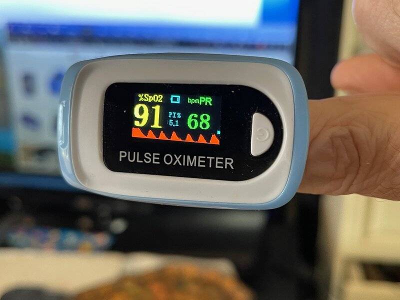

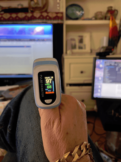

Yet, any $25 IR oximeter across any finger or toe can accurately plot the modulation of pressure by the transmission of light thru the network of blood expansion. Then display the pulse rate in BPM and O2 concentration using the ratio of IR & Red light in a matter of seconds. However, if your finger is also touching something causing vibrations in pressure, this will disturb the automatic gain (AGC) and offset (AOC) control of detected light to optimize the signal.
I would try to let go of your DIY Flintstone idea (but nice try) and get yourself a Pulse Oximeter and compare fingers, toes for O2 content from aging lung disease or COVID if it drops well below 90%. (then get help soon) If you can't get a pulse, seek help very soon. (it happened to me in my right median artery, with arm pain symptoms, then after 5 "roto-rooters" still no wrist pulse next day, followed by Median Artery bypass 3.5 yrs ago and still have neuropathy in 3 fingers related.

Added oximeter display.
%SpO2=91 %
P.I.% = 5.1 %. As the peaks get bigger, this increases
Rate = 68 BPM
TonyStewart said:
SpO2=91
That's pretty low. Is that normal for you?
No. Thanks for asking. Yes anything consistently < 90% is of concern and 91% seems be the 1st time I've seen it this low too. Perhaps the low battery icon has something to do with accuracy, but I think it's just spending too much time resting on PF. I took another reading now and it averaged 95% sand went up to 97-98% momentarily when I scurried into the kitchen while breathing faster. But static breathing rate changes normally do not change %SpO2 as much as one expects and hardly budges it, indicating other chemistry chains need to be triggered for demand work. At age 70 in otherwise good condition it was consistently 98% last year when I was a "smoker" . Go figure, yet my lung spirometry tests always scored well when healthy. Red Vf being near 2V and close to a low battery voltage of two AAA's in series might explain the error but I would expect a better design from the Chinese but that might add a few pennies to the cost. ;)
