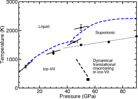

It is not normal ice. Normal ice at that temperature would melt. But the increased pressure form "special ice". See in the phase diagram where there are lines between blue areas? These are the boundaries of different types of ice (different crystal structures). Ice at the temperature and pressure you are looking at would be more dense than liquid water, which is something you wouldn't expect otherwise, no?
