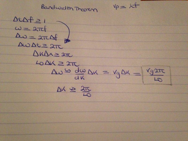

Consider a propagating wave packet with initial length L0.
Use the bandwidth theorem to show that the minimum range of angular frequencies present in the wave packet is approximately:
\begin{equation}
\Delta \omega = \frac{v_{g}}{L_{0}}
\end{equation}
where vg is the group velocity.
The dispersion relationship for the wave is:
\begin{equation}
\omega ^{2} = gk
\end{equation}
attached as photo along with original problem sheet. For some reason I get the answer as:
\begin{equation}
\Delta \omega = 2\pi \frac{v_{g}}{L_{0}}
\end{equation}
see method attached.

Yes i agree with your result. but how exactly have you been taught the bandwidth theorem? I just know it as \Delta k\Delta x\approx 2\pi where \Delta k , \Delta x are defined properly.
Well, yeah we defined it as \begin{equation} \Delta k \Delta x = 2\pi \end{equation} and then the rest can be derived from there.
