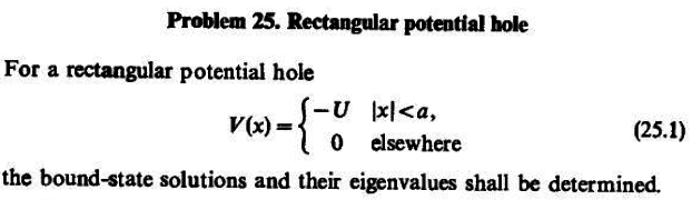

Is the solution given below wrong?

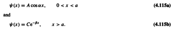

I believe the ##x## in (25.2) is wrong; it should be replaced by a constant, such as ##\beta##, because ##E## is a constant and not dependent on ##x##.
Should the correct answer be
even solution:

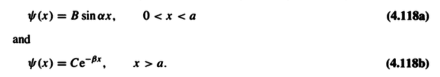

odd solution:
where
That is not an x but the greek letter kappa.
