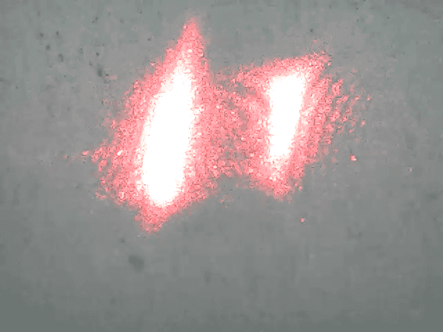

I made experiments in my room and I think I am able to observe the wave function without its collapse, can anyone assist me?
So what am I doing wrong here? I can clearly observe it, I'm nearly sure I can tell which particles are going throw each slit if I used another laser too. My suspicion is that the electrical current of the photon detector that uses germanium or silicon to detect the particles are influencing the outcome, as with a microscope, some lasers and two slits are able to produce consistent results. I filmed these and showed to a buddy of mine (that works at a particle accelerator) that told me his head "bugged" once he saw the video.
Am I doing something wrong here or can someone help me out with a scientific research article in case it is something relevant to the quantum mechanics world? (I have a background in economics and computer science)

You will need to provide much more detail than this if you expect anyone to be able to make any useful comments...
...particularly if you are claiming this.
Clearly observe what? All I see is a blurry image of...something.
If what you have here is a detector screen that is showing some kind of image of light after it has gone through a double slit apparatus, I have no idea why you think you are "observing the wave function without its collapse". You are just seeing a blurry version of an interference pattern, which is exactly what you should expect to see, and what everyone who has run this experiment since Thomas Young first did it in the early 1800s has seen. (I assume it's blurry because whatever home-built apparatus you have is not very accurate.)

If what you are showing is an image of a detector screen with an interference pattern, no, you don't need quantum mechanics to explain that. The classical wave model of light explains it just fine. In fact, the Thomas Young double slit experiment I referred to in my last post was one of the key experiments that established the classical wave model of light.
I think I clearly observe the interference pattern with a laser, two slits and a microscope recording acting as the detector. Yes, I am aware that light travels in a wave format. But, the double slit experiment with photon detectors seem to "collapse once observed".
Me and my friend seem to agree it shows the interference pattern, but I got that while filming and watching it. At which point should the wave function collapse? shouldn't it collapse once it is observed? How come the output doesn't collapse like they do with photon detectors?
Also, thank you so much for taking your time to look into this, we are really confused about my results as it did not get the "collapse" expected. the results is a video that seems to be showing the wave function and at no point it collapses. Yes it is blurly as the equipament I have at home isn't the best. I do live 5 minutes away from my countries' equivalent of harvard, so I guess I could go there and ask professors for better equipament to reproduce my experiment more professionally. I just really don't want to waste anyone time and understand better what's going on.
The wavefunction is not a "thing" that you can see. It's an abstract mathematical construction that underpins the theory of QM.

So I'm using lasers that continuously shoot out photons. The microscope seems to pick up wavy patterns once the laser goes through both of the slits. Since the microscope is recording (I'm also straight up looking at the experiment going on) doesn't that count as an observation?
As to which photons pass through which slit, I'd imagine I can use two laser pointers with different colors and than check out the recording to see which colored photons are at which side..
I'm a bit lost on the there is no way to observe a photon, lasers shoot out many photons and I'm able to observe it. Individually I'd need a super microscope I guess, but I don't really see how that would influence things if I seem to be able to record and observe the pattern...

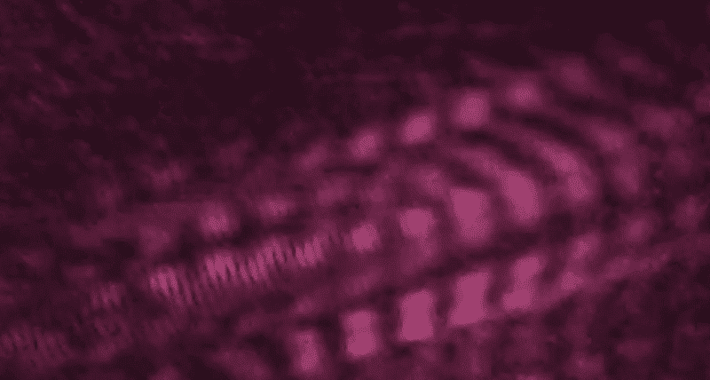

Also, I'm very curious about some of the results of my experiments, like this frame shot from one of the videos I made... if you zoom out it looks even more like a wave...
Is not the experiment you are running. With a light source that has low enough intensity that individual "photon" impacts can be seen at the detector (i.e. individual dots of light that, over time, build up an interference pattern), then you do need to bring in quantum mechanics to explain what is going on. But you're not doing that.

Each individual photon impact on the detector in the low intensity version of the experiment I described above corresponds to a "collapse" in QM, yes. (But what exactly "collapse" means depends on which interpretation of QM you adopt. Discussion of QM interpretations belongs in the interpretations subforum, not here.)

With the version of the experiment you are running, the "wave function" viewpoint isn't even necessary. Basically you are looking at an interference pattern formed by classical light. Such light can, for all practical purposes, be viewed as "always collapsed". There is no need for QM or "collapse" at all in analyzing the experiment you are running. If you want to test anything about QM, you need to have a different apparatus that can run the low intensity version of the experiment I described above.
No, it doesn't, it shows a classical interference pattern.

An "observation", as far as QM is concerned, happens as soon as the light hits your detector.

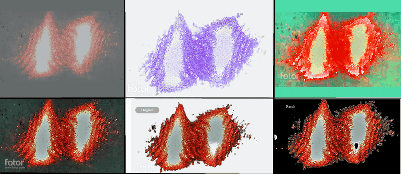

Also, I've played around a bit with photos inhencer to see how the results could look like before getting the next experiment setup
