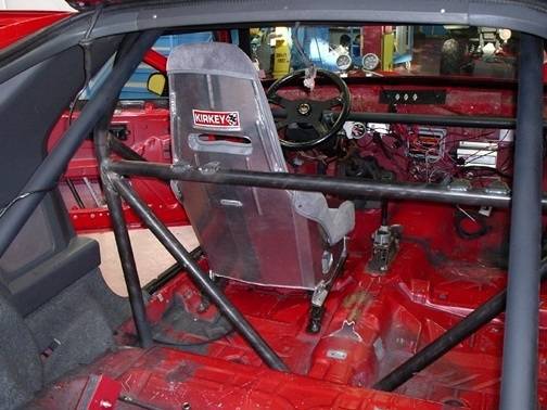

teachable moment- this into compact unibody cars..e funny car scene hit in the early 1960s. was NHRA class A/FX which was Factory eXperimantal. this was Detroit stuffing huge 400 plus cid V8s into comapct unibody cars...these unibody desighns did not have the heavy full channle frames on which the body was bolted. unibody deign used a stamped sheetmetal floorpan and relied on the windshield and sheetmetal roof / pillars to tie the body together...anyway..when you nailed the throttle the twist would crack the windshield so we have to tie the front and rear sheet metal channels together to reinforce the body...NHRA mandated a full roll cage that took care of this problem, we welded in tubing to connect the rear spring mount points to the main roll cage hoop and ran tubing to the front end to tie in the whole pan. this reinforced the floor pan and assisted in weight retransfer to the rear. we still had twist but could control this with traction bar setting or pinion snubber setting , springs and shocks..
http://img135.imageshack.us/img135/440/328lvl.jpg
Just thought I'd throw in another example of torque weight transfer...
case study in weight transfer

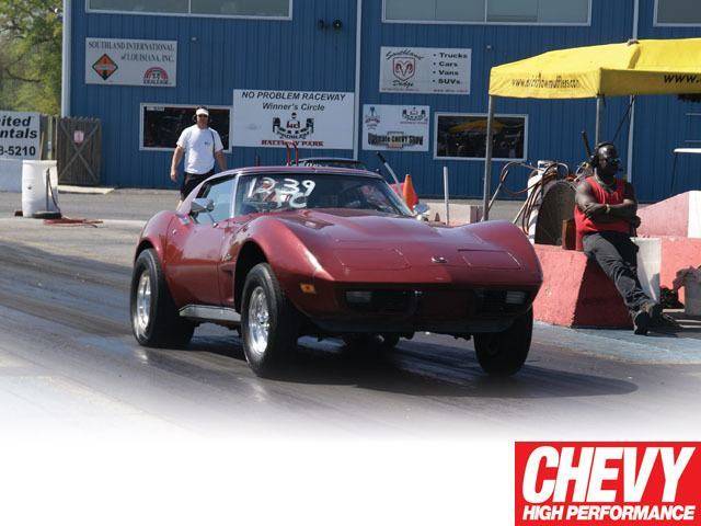

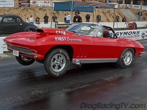

Lastly, you won't see this occur in a car with an independent rear suspension as the differential is essentially bolted to the chassis and the axles aren't able to transmit force in the direction of the ground (since they are jointed at each end).
yeah..it will never happen with them independent rear suspensions
note: these vehicles have independent rear suspensions
