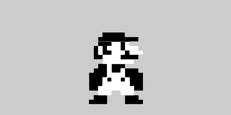

i thought that was the coolest thing i'd ever seen ever until i realized that it was not a miracle but rather a necessity that there was a value of n that drew the formula.
a little disappointing...
this is for n = 22701801293785014193580405120204586741061235962766583907094021879215171483119139894870133091111044901683400949483846818299518041763507948922590774925466088171879259465921026597046700449819899096862039460017743094473811056991294128542891880855362707407670722593737772666973440977361243336397308051763091506836310795312607239520365290032105848839507981452307299417185715796297454995023505316040919859193718023307414880446217922800831766040938656344571034778553457121080530736394535923932651866030515041060966437313323672831539323500067937107541955437362433248361242525945868802353916766181532375855504886901432221349733
haha...that's sweet!
