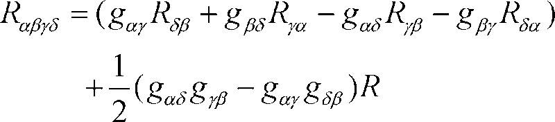

Hello, I wish to show that on 3-dimensional manifolds, the weyl tensor vanishes.
In other words, I want to show that the curvature tensor, the ricci tensor and curvature scalar hold the relation
Please, if anyone knows how I can prove this relation or refer to a place which proves the relation, I will be most grateful.
Thanks in advance

Start with the identity;
[tex]R_{ac}=3R_{ac}-R_{ac}-R_{ac}+Rg_{ac}- \frac{R}{2}(3g_{ac}-g_{ac})[/tex]
then, rewrite it in 3D, i.e put;
[tex]3=g_{a}^{a}= \delta_{a}^{a}[/tex]
So,
[tex]g^{bd}R_{abcd}=R_{ac}g_{b}^{b}-R_{bc}g_{a}^{b}-R_{ad}g_{c}^{d}+R_{bd}g^{bd}g_{ac}-(1/2)R(g_{ac}g_{b}^{b}-g_{bc}g_{a}^{b})[/tex]
or;
[tex]g^{bd}R_{abcd}=g^{bd}[R_{ac}g_{bd}-R_{ad}g_{bc}+R_{bd}g_{ac}-R_{bc}g_{ad}+(1/2)R(g_{ac}g_{bd}-g_{ad}g_{bc})][/tex]
Now, in 3D, Reimann and Ricci have the same number of independent components (6 each). Therefore the Reimann tensor is determined completely by the Ricci tensor and the above equation gives;
[tex]R_{abcd}=R_{ac}g_{bd}-R_{ad}g_{bc}+R_{bd}g_{ac}-R_{bc}g_{ad}-(1/2)R(g_{ac}g_{bd}-g_{ad}g_{bc})[/tex]
