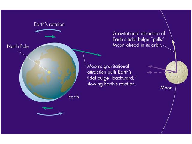

So I THINK I understand that the tidal bulge is resting slightly in front of the moon because of the Earths rotation and the moons gravity, it pulls the moon 'forward' a little adding energy to the moons orbit and expanding it, what I do not understand is why the Earths rotation is slowing. I think I understand that it the energy of the tides (And also tidal electricity generation) has to come from somewhere. Could somebody please explain to me why mechanically the Earth's orbit slows down? Also do these tidal interactions occur with the atmosphere and mantle? Can these tidal interactions occur between hypothetical 100% solid bodies, if so to what extent? Also if my original assumptions are wrong please let me know, as I know you will. Thank you for your time. :)

The moon has a braking effect on Earth's rotation due to tidal friction. This also causes the moon to slowly recede from the earth. It will eventually become tidally locked with earth, but, probably not before the sun incinerates it.

The Moon's gravity pulls on the bulges, and the bulges pull on the rest of the Earth. So as the Moon is pulled forward by the leading bulge, the Earth is pulled in the opposite direction, which slows its rotation down.

Here's a pic from a random website showing the interaction Drakkith described:
tidalbraking.jpe

In short, you don't get tidal braking from a 100% rigid solid, as the tidal potential can't produce a tidal bulge. Since such a thing doesn't exists in reality, you end up with varying degrees of tidal interactions depending on composition - the atmosphere responds differently than the oceans, which differ from the crust, which differ from deeper, denser regions of the planet.
