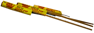

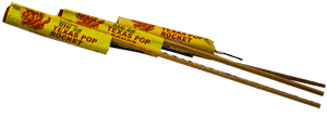

A bottle rocket. It is better when low cost, simplicity, east of transportation and operation, and self-contined launch facilities, are the dominant factors..
k
If you don't like this answer, then you must define what you mean by advantageous or better.
