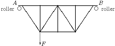

For the bridge shown in the diagram, find the components of the reaction force at A.
sum of force = 0
sum of force y = 0 = Ay+by-F=0
Moment at B = 0 =-Ay*4 +F*3
therefore Ay = 3F/4
and Ax =0 (roller)
Correct.
thanks, i put my solution in backwards online
