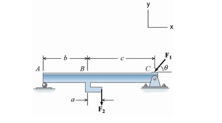

Hello everyone,
For this equation, I have found Ay as 0.677kN by using Ma = 1.5kN(7m)-Ay(15.5m).
To find Cy, would I be using the sum of forces to find the answer?
For example Fy = Ay - F2 - F1sin55 + Cy = 0
This would then get Cy answer as 2.05kN

Looks right.
Hi. Method is fine but pay attention to detail.
E.g. Don't use 'a' for 'A' (as in 'Ma'). Don't forget to say MA equals 0. Personally I would just say 'moments about A' rather than 'MA'.
So it would be clearer to write the equation as (for example):
1.5kN(7m) - Ay(15.5m) = 0 (moments about A)
I would use one or two additional significant figures for intermediate-step answers (e.g. Ay = 0.6774kN). This reduces accumulated rounding errors in later steps. Round final answers as appropriate at the end.
