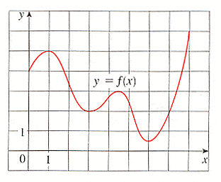

2.Consider the following figure.
Use the graph of f to estimate the values of c to the nearest 0.1 that satisfy the conclusion of the Mean Value Theorem for the interval [1,7]. (4 answers "c=___")
I'm lost on this one.
Do you know what the conclusion of the mean value theorem is? That would be a good place to start! What are f(1) and f(7)? What is (f(7)- f(1))/(7- 1)? Why am I asking those questions?
