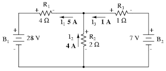

What are the equations for solving combined circuit problems?

i honestly have no idea where to start. may someone pls help me?

Can you identify any resistors which are in series and can be combined?
is 2 and 4 in a parallel circuit as well as 3 and 5?

When the current reaches the bottom end of resistor 5, where will it go?
back to resistor 1?

No. I mean the bottom end of 5, in the lower right corner. The current flows down through 5, and then where?

oh to resistor 4?

Right. And then when it leaves 4, where does it go?
resistor 3 and when it leaves 3, it goes to 2? and when it leaves 2, it goes to 1?

Not quite. When it leaves 3, there are two places it can go. But, looking at sidt36's post #4, what can you say about 3, 4, and 5?
3, 4, and 5 are parallel to each other. does that mean that 1 and 2 are series?

No! Read sidt36's post again.
No.

is it the opposite?
I'm not going to do the problem for you.

yes, i understand that but i don't get what makes a circuit a series or parallel.
Try making a diagram like this and check where the the current is going

You haven't stated what you are trying to solve for. What do you need to find? What is the actual problem statement?
