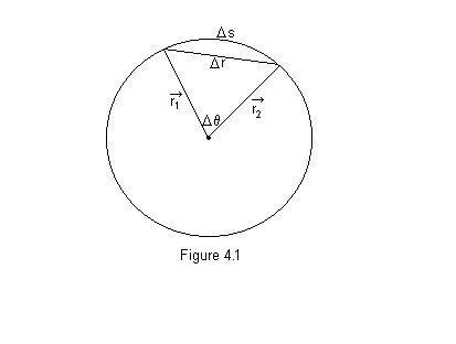

So what can i do to find the displacement ?
check the image to be clear. the chord represents displacement and the arc represents distance.
calculate Δθ from the given data. Then a bit of trigonometry should give you the answer.
  • Figure 4.1: circle with centre point, two radius vectors r1 and r2 meeting at angle Δθ, a chord labelled Δr and an arc labelled Δs between the endpoints.

Plutonium88 said:
d)Δθ=ΔS/R
where S is my distance from C (S2-S1)/R = S2/R
what is C ?...center point of circle??
the formula is right. calculate the distance just like you previously did and that distance is ΔS.
Plutonium88 said:
and then use cosine law with the angle.. Also was a type for the formula mac=mv^2/R , it was indicated in the beginning.
yes, that should solve it for you.
