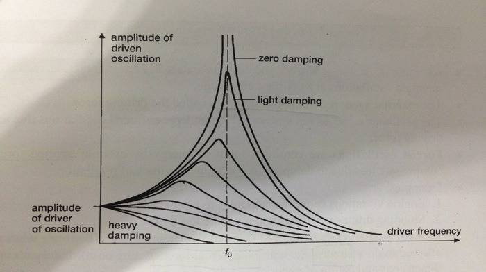

Hi!
I have a few questions about resonance:
1) What exactly is the "amplitude of driver of oscillation"? And why is the amplitude of the driven object equal to the amplitude of the driver right from the start when the driver frequency is 0?
2) Is the driven system originally oscillating?
3) In reference to the 'light damping' curve, why does the amplitude of driven oscillation increase between 0 and f₀, but decrease after f₀?
4) Also, is a system's natural frequency fixed? eg. No matter how hard I push someone who is sitting on a swing, the amplitude will increase but the frequency will remain constant? How about a brass instrument?
Just started learning this topic so I may have many misconceptions - hopefully a simple basic explanation about the concept of resonance would be good.
- a very confused student

This plot is in respect with a forced (or driven) oscillator.
A periodic force is applied to the oscillator. The force has an amplitude and a frequency (fd).
The oscillator itself has its natural frequency, fo. This one is fixed for a given system and is the frequency at which it will oscillate if there is no driving force.
If it is driven though, it will oscillate with the frequency of the driving force (fd). The amplitude of this oscillation will depend on how far is fd from fo.
The amplitude of the driver is the maximum displacement of the force of the driving mechanism i.e the external force the pushing or pulling that is being applied to force the system into an oscillation. The driven system is initially at rest so when the driver force is applied it responds to it in kind.
The driven system can be oscillating or not.
The graph shows you the response of the system to different driving frequencies, Resonance is a phenomena in which some energy provide to a system by the driver is stored in that system as measured by amplitude of its oscillations or vibrations. The closer the driver frequency is to the resonance frequency the more energy is stored in the driven system as seen by the increase in the amplitude i.e. the size of the vibrations.
The natural resonant frequency is fixed. With regard to the swing the natural frequency is determined by the length of the ropes as a swing it is a simple pendulum. Changing the driver frequency so that it is "off resonance" will result in a smaller amplitude. The swing might oscillate at the driver frequency if it is strong enough.
To see a vivid example of resonance and it importance in engineering Google the" Tacoma Narrows Bridge" for a famous example
On a small point regarding (4), if we take the example of an electrical LCR resonant circuit driven with a sine wave, I think that the only frequency present would be the driving frequency, irrespective of the resonant frequency of the circuit.
This is true for any system, after the transients are damped.
