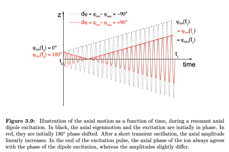

Thanks for the details, I will go through them carefully, but I might miss-explain my problem (and overcomplicate it). For concreteness, in my setup I have an ion at the center of a Penning trap (I can provide detailed references about this kind of setup if needed). It is common practice (for various purposes), to excite the axial motion of the ion (if we ignore thermal noise, we can assume that the ion is at the center of the trap with zero velocity initially) to a given amplitude then let it oscillate. One can damp the ion motion by coupling the Penning trap to an RLC circuit, such that the induced image current due to the ion motion thermalizes the ion very fast. However, if one changes the RLC resonant frequency enough, the ion will not be damped basically over the time scale of the measurement (ms to seconds) and this second case is where I am at. In all the papers I read about this, they simply assume that the ion motion (after this initial kick which can be done in various ways, including applying a resonant force) is simply oscillating at the resonant frequency i.e. ##A_d\cos(\omega_0 t)##. I am not sure where the extra math comes in, as it seems like I am getting in the end the same behaviour as they are getting. I am not sure what am I missing (am I oversimplifing the problem?)
Edit: I am attaching below a figure I have from a PhD thesis (I will try to find the actual thesis). By applying a dipolar excitation they are able to bring the ion to a given axial amplitude of choice (in this case they have thermal noise, so the initial phase affects the final amplitude, but this is exactly what I want to estimate for my setup, too). The point is that once they reach the amplitude they want, they turn off the excitation and the ion simply oscillate as I mentioned above.
and @vanhees71 I notice that the above graph shows / assumes that the amplitude of the oscillations grows in equal steps. The model assumes the amplitude of the sinusoidal applied force is constant. How to apply a familiar electrical analogue to it? The force from the applied field would have constant amplitude, independent of the motion of the ion (I assume). Thing is, I'm looking for a real damping effect to produce an inverse exponential approach to a real maximum. What would actually be supplying this damping?
It's hard to say, what exactly is written in the PhD thesis. If it's final and the candidate has defended it, usually it's made public. So you should be able to find it in the internet.
What I could imagine is that the plot shown in #11 is indeed describing the resonance case for the (nearly?) undamped oscillator, because then the amplitude rises linear with time.
We need a particular solution or the inhomogeneous equation for this case. Of course you could use my method with the Green's function, but it's maybe more illuminating to do it from scratch. What does not work, is the "ansatz of the kind of the right-hand side", because you'll not find a solution for the amplitude. That's because of the resonance catastrophe. We use the method with the complexifed right-hand side. At the end we take the imaginary part to solve for the original real equation in #1.

$$x_{\text{phys}}(t) = \left (-\frac{A}{2 \omega_0} t+C_1 \right) \cos(\omega_0 t) + C_2 \sin(\omega_0 t).$$
For the initial conditions ##x_{\text{phys}}(0)=0## and ##\dot{x}_{\text{phys}}(0)=0## you find ##C_1=0## and ##C_2=A/(2 om0^2)##, i.e.,
$$x_{\text{phys}}(t)=\frac{A}{2 \omega_0^2} [\sin(\omega_0 t)-\omega_0 t \cos(\omega_0 t)].$$
For ##t \gg 1/\omega## the 2nd term is dominating, and the asymptotic behavior is thus a harmonic oscillation with linearly growing amplitude.

Thanks a lot, that formula makes more sense (in terms of not getting infinite amplitude without damping). So for my case, I need first to know for how long to apply that force such that I can reach a given amplitude ##A_d## (and how would the system behave after that). At that point I don't want to increase the amplitude anymore and just let the ion evolve without any external intervention. So I need at a given time ##t_0## the amplitude to be ##A_d##. If we assume that ##t_0 = 2\pi / \omega_0## (which can be done by adjusting the value of ##A## experimentally as needed) we get that ##A_d = x(t_0) = -\frac{A}{2\omega_0^2}\frac{2\pi\omega_0}{\omega_0}##, so we get that we need ##A_d = \frac{A\pi}{\omega_0^2}##. We also get, as desired, that ##\dot{x}(t_0)=0##. At this point I turn off the external force, so if I redefine this ##t_0## as my starting point, I should simply get that the ion moves as ##A_d\cos{(\omega_0 t)}##. Is this not right? But this basically gives what I got in my initial post, no? Am I still missing something in my derivation? Thank you!
For that you just use the Green's function. It's not so easy to solve the equation directly for a force that's not harmonic.
But what is wrong with my approach above? The formula you provided is true for a continuous harmonic force. So at a given time ##t_0## the amplitude is given by that formula (the formula doesn't know whether I will turn off the force or not after that). But if I turn it off, the system should evolve as a free harmonic oscillator and in the end I get the result from above. I really don't see what step above is wrong? Also this behavior based on my result is basically what they observe in measurements in Penning traps (simple, undamped harmonic oscillations).
I also looked more carefully at the derivation from here. Equation (25) is exactly what I got in my first post. Why can't I use that in my case?
I guess I don't understand why do I need Green functions in order to get what I need, given that my result appears consistent with experimental observations (and some other derivations I found online). I assume that using Green functions is a more general approach but I don't see what is the difference, in my case, compared to my approach.
Obviously Eq. (25) doesn't work for ##\gamma=0## and ##\omega_d=\omega_0##. That's why you have to treat this case separately as in #14.
If the harmonic motion acts only for a finite time, you need to use the Green's-function formula in #8.
