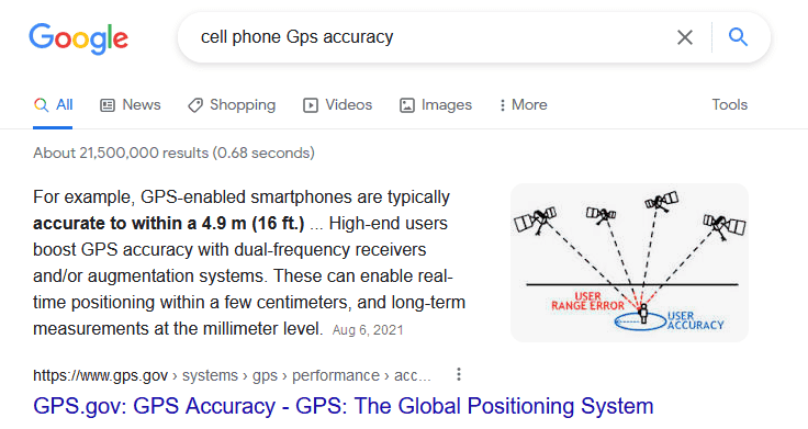

I'm asking, if you put a 5G smart phone on the ground, and drew a circle around it where it's laying. Can it be tracked? And if so, what would that radius be?anorlunda said:Can you rephrase the question? I'm not sure what radius you're asking about.

I guess what I'm really wanting to know is, if I'm carrying a smart phone, how closely can I be found. From my location, there should be a circle around me where I can be found. What would that radius be?anorlunda said:It will be pinging the nearest cell tower. That places you within the radius of the tower's range. That's the same for 2G, 3G, 4G, and 5G or any cellular technology. 5G should be no different.

Does it have its GPS location feature enabled?dlgoff said:I'm asking, if you put a 5G smart phone on the ground, and drew a circle around it where it's laying. Can it be tracked? And if so, what would that radius be?
Or are you asking what is the tower-only location resolution and accuracy compared to 4G?

Assuming it does and it's enabled, How close to where the phone is can it be found. BTW I don't have a smart phone. I am just curious about how close I could be found; say I was lost somewhere. i.e from my position, there should be some circle around me where the phone could be found.berkeman said:Does it have its GPS location feature enabled?

It looks like it's pretty good. The GPS accuracy will be independent of 5G or 4G, etc.dlgoff said:Assuming it does and it's enabled, How close to where the phone is can it be found. BTW I don't have a smart phone. I am just curious about how close I could be found; say I was lost somewhere.

Okay. Thanks berkeman. That's exactly what I was looking for. 16 feet.berkeman said:It looks like it's pretty good. The GPS accuracy will be independent of 5G or 4G, etc.
