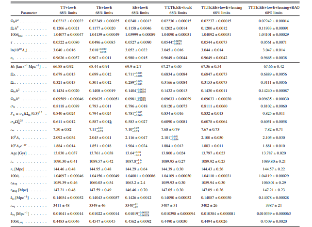

In cosmology, CMB tells a lot about which cosmological model can be acceptable or not. For instance we know that, whatever the cosmological model we use ##\theta_*## parameter will be always the same. Is there any other parameters that is listed in this picture is **model-independent** ?(i.e always stays the same for any given model)
https://arxiv.org/abs/1807.06209

There's not really any such thing as a model-independent parameter, unfortunately. The parameters make up the model.
I think what you're asking can be more correctly rephrased as, "Which parameters are constrained tightly by the CMB data, and don't change much based upon model assumptions?" I think the main ones there are the matter densities (##\Omega_b h^2##, ##\Omega_c h^2##, ##\Omega_m h^2##) and the distance to the surface of last scattering (##r_*##).
That's not quite the right chart to understand this, however. The columns are not different models, but different sets of data.

kimbyd said:
I think the main ones there are the matter densities (Ωbh2, Ωch2, Ωmh2) and the distance to the surface of last scattering (r∗).
Yes indeed.
